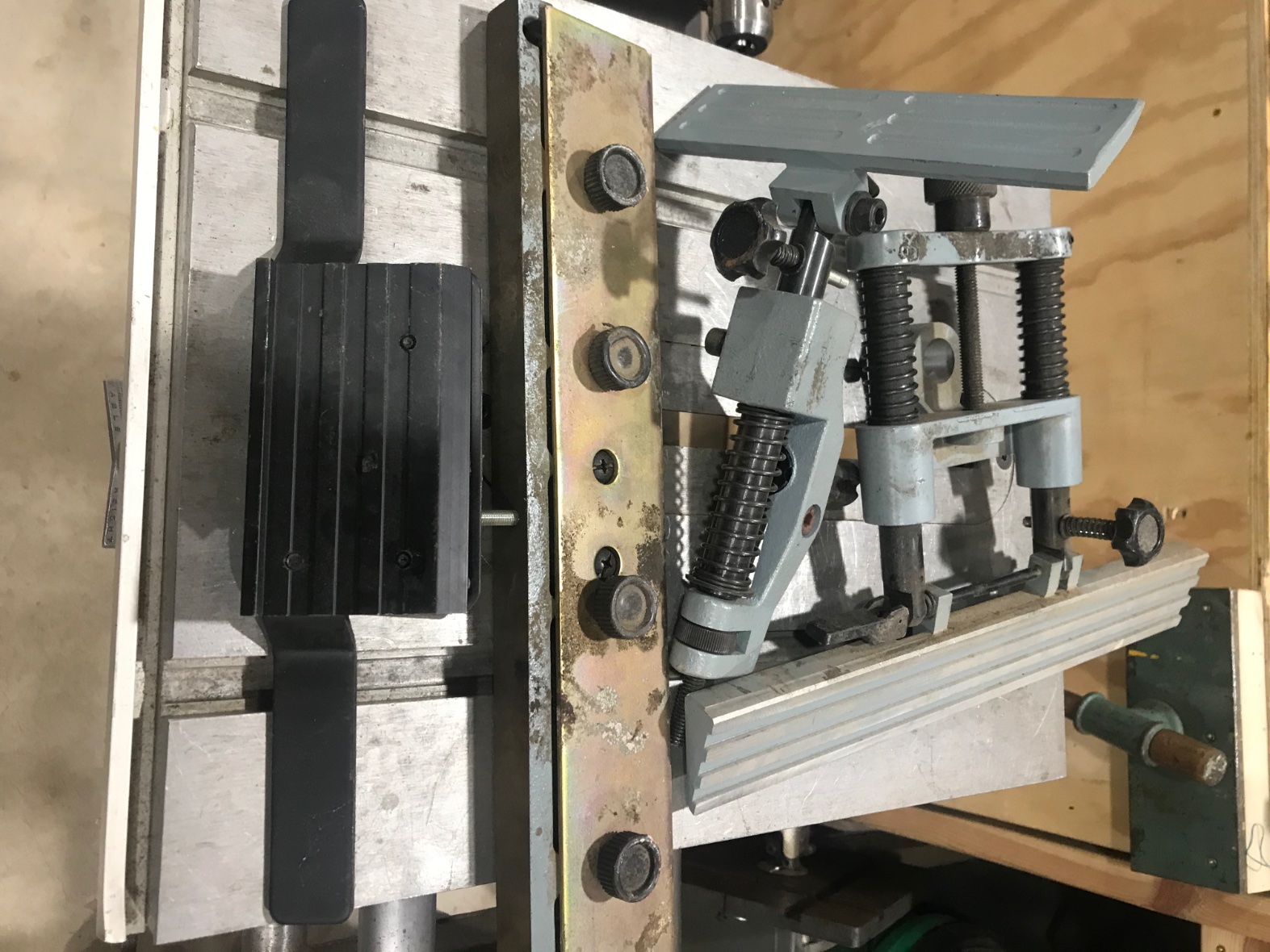

Hi, SS newbie here. Picked up a SS, I think it’s a 1979 Mark V S# is SS 41594. It has some items I don’t recognize at all. Can anyone help identify them?
- C4B4D58D-E917-4812-8FFF-4A5EDADDEA8B.jpeg (516.12 KiB) Viewed 4014 times

Nope! Somebody else made then.
Re: Help identifying parts
Cool looking parts. No idea what they are.

tprowood.
Welcome to the Shopsmith Forum. Serial number SS 41594 is indeed from 1979 and August to be more precise.
I have found it is common to get non-Shopsmith parts when buying a used Shopsmith tool. I cannot identify the parts in question other than they are sitting on a Mark 5 Main Table but they do look intriguing. I wonder what they are used for.

Thanks for the replies. They, parts pictured, area quite heavy duty. Can anyone help me hone in on the model type, SS 41594, is? Is it a Mark V 500? I need to do a few repairs, and need to get the right ones. Thanks.
Definitely a Mark V 500. Often just called a 500. Almost all parts aside from the table systems are compatible across the line of Mark 500,505,520, and Mark 4 machines. Except for the conventional headstock instead of the PowerPro compatible with the Mark 7 as well. New parts are available from Shopsmith and many used parts can be found on eBay. Many bearings, screws, roll pins, etc. are standard sizes with many sources.

My "pixel ruler" suggests that the round protrusions on what looks like the long heavy piece might fit into the Mark V miter slot. Can you check that and, if it fits, post a pic of the other side of that piece? It might shed some light on the other pieces.

tprowood,
At the time your Shopsmith was made there was only one model the Mark 5. Notice I called it a Mark 5 and not Mark V which changed in 1980 to using the Roman numeral instead of the number. The Shopsmith tool itself didn't change at that time.
When Shopsmith Inc. (the company) introduced the larger Table system in 1985, it was the Mark V model 510 and included floating tables. The Mark V 505 was the same as the Mark V 510 without the floating tables. The Mark V’s with original table system became the model 500. Mark 5/V's made prior to the induction of the Mark V 510/505 are commonly referred to as 500's also. It is important to know that it is the Table/Fence/Carriage system that makes the difference between the 500, 505, 510 and 520 Mark V's. There are a few other differences between these models too. The 500 uses different Upper & Lower Saw Blade Guards (several variations), a different Lathe Tool Rest (shorter arm & different post) and Arbors (shorter) than the other Mark V models use. There are some differences in accessories too. For example, the Shaper Fence is different for the 500 than the one for the 505, 510, 520, Mark 7 & 4. The Mark VII from the 1960's has its own version of the Shaper Fence. The current Mark V 520s is different than the earlier Mark V 520 since it, along with the Mark 4 & 7, have the double tilt bench ends and the Main Table posts have the raising/lowering teeth on both sides. Features that came out with the Mark 7.
Since your Shopsmith is a Mark 5 with the original table system it is important to look carefully when buying any used parts. Some sellers have no clue that a table part may be for a Model 500 (original) or belong to one of the other Mark V models and you can see parts mis-listed often. Shopsmith has discontinued the original 500 table system and has few if any parts for it. As has already been said you can buy new replacement parts from Shopsmith for the Headstock. Bench parts from Shopsmith will no longer have the original Base & Arm and Headrest & Tie Bar once stock runs out but instead will have the Double Tilt ends. Plenty of these are available on the used market partly from people who have upgraded their Mark V to the Double Tilt Bench Ends. Do note that originally the Mark 5 (all Greenie's) had larger Bench Tubes and therefore the Bench Ends are different than later Mark 5/V's like yours. This is why it is important to know the age of not only your Mark 5 but the parts you are buying. Sometimes it makes a difference.
Here is some good news for you. All upgrades made over the years for the Mark 5/V can be added to older Mark 5/V's. Even the changes to the Mark V to make the Mark 7 can be added. I have an upgraded Mark V that is now a Mark 7 with a Power Pro Headstock and Double Tilt ends.
