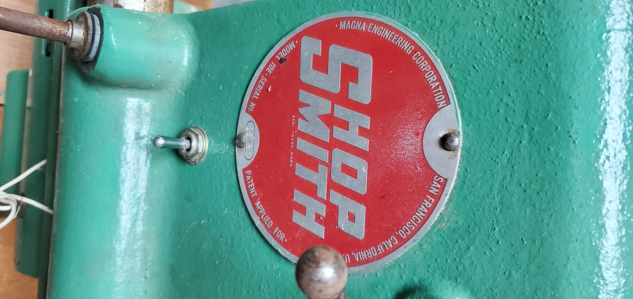

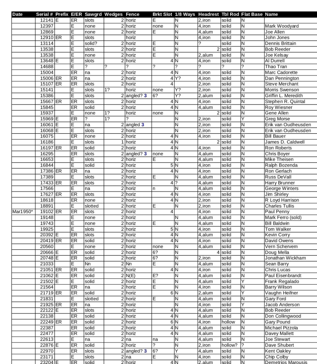

I looked up some info...looks like March 1950 model if looking at the chart correctly.
10E s/n 22190

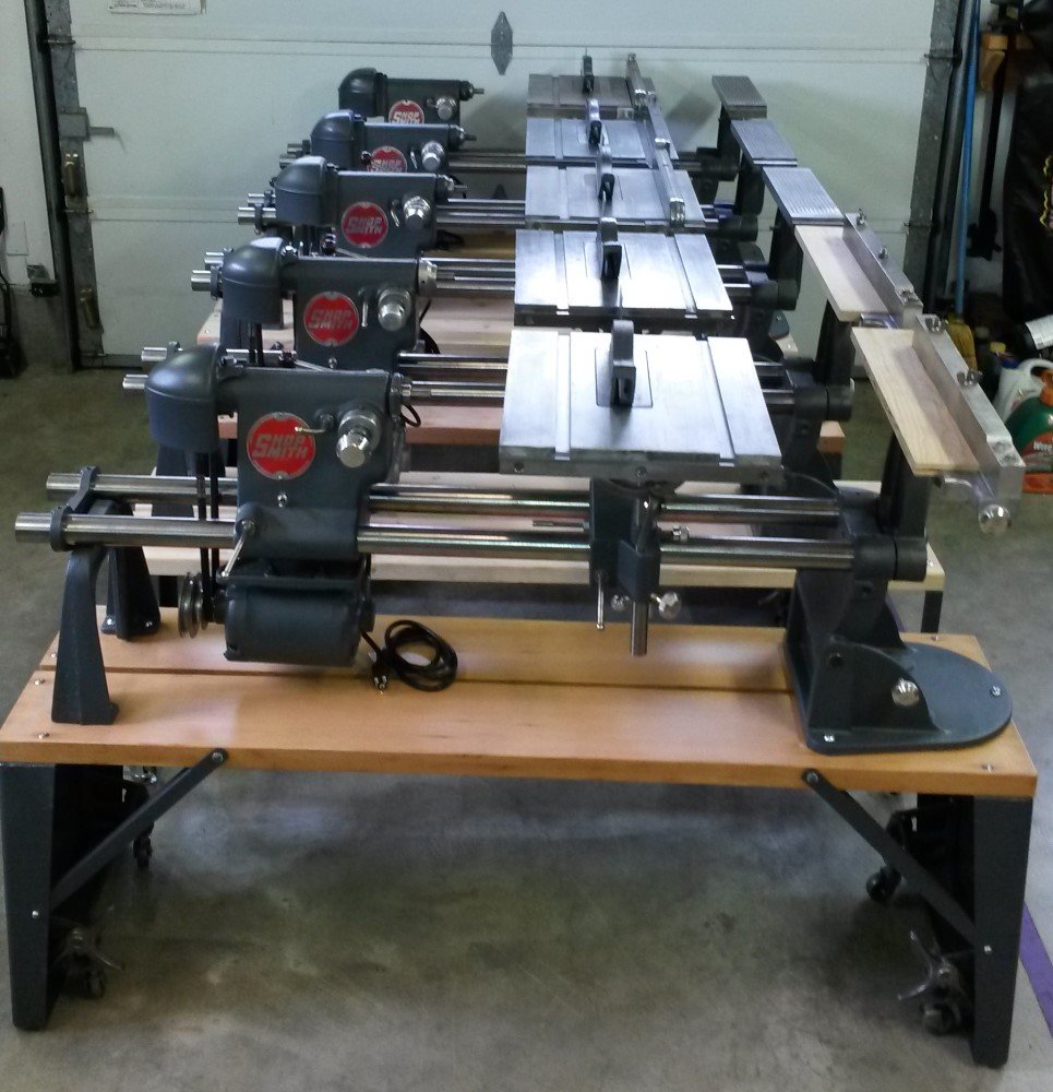

Besides other Shopsmith tools, SPT's and accessories I have, to date, restored 24 Model 10E and 10ER Shopsmith tools. The picture above is when I happened to have 5 restored and not sold yet. The one in the back of the group is the first one I restored and still have. The other 4 have been resold.
If you wish to make a Wood Extension Table (like the ones in the picture above) for the Bracket you have, I can give you the dimensions. You would need the threaded studs, washers and wing nuts on the Tailstock to use it and an original Fence plus hardware to hold a Fence on it. Note how the Fence is attached to the Wood Extension Table in the picture above.
I'm not sure what chart you are looking at but 10E S/N 22190 would likely have been made in 1948. By 1950 they were Model 10ER Shopsmith tools.I looked up some info...looks like March 1950 model if looking at the chart correctly. 10E s/n 22190
- Screenshot_20240315-203626_Write on PDF.jpg (314.82 KiB) Viewed 9681 times
