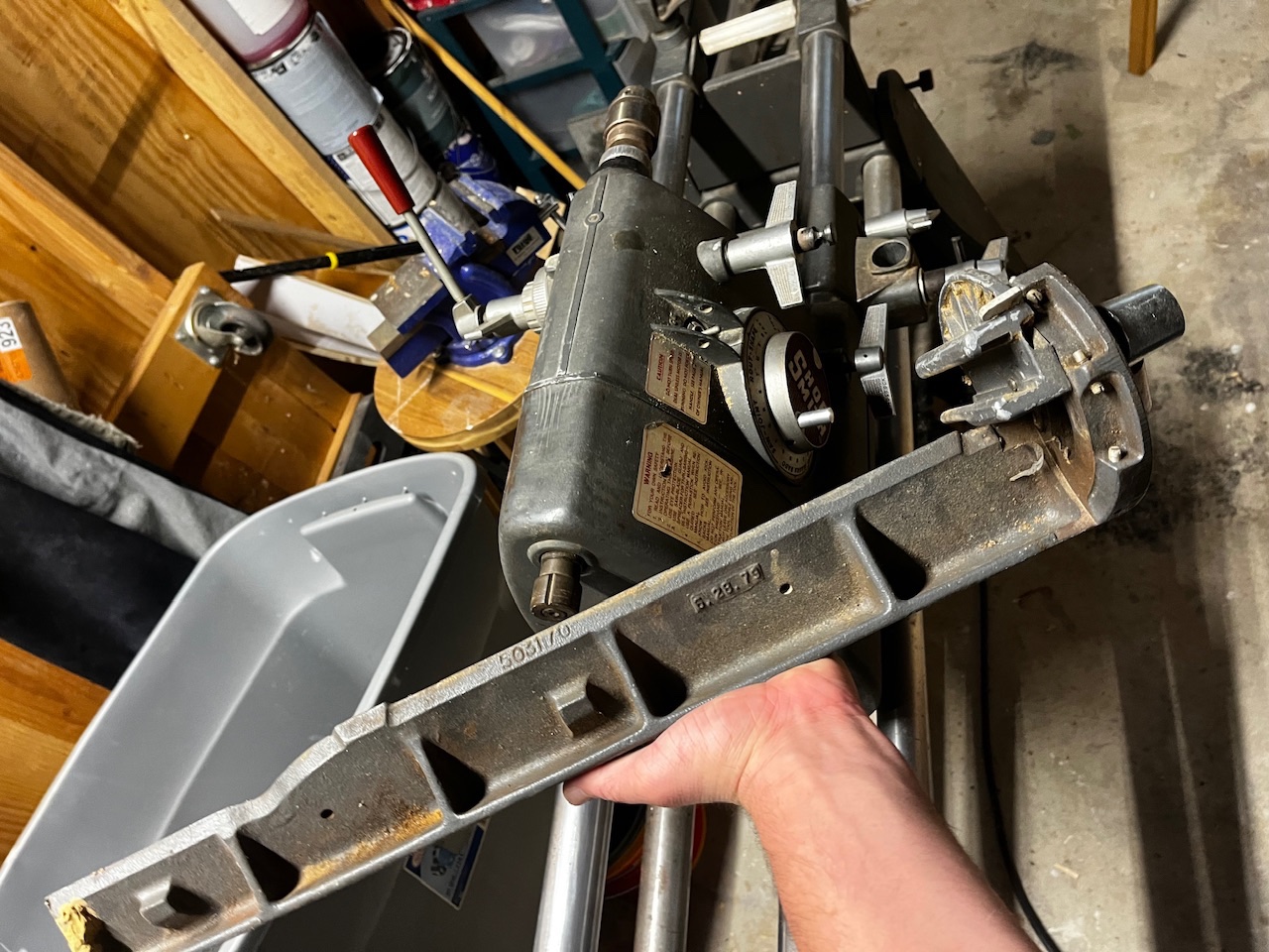

I have no idea what I got into. I typed the serial number in and it’s “not found” ! What is this “fence” thing?

youngstev wrote: Sun Apr 21, 2024 4:14 pm

The serial number indicates it was manufactured in 1994, and I believe week 05 but I could be wrong on that last part.
The fence is for the Jointer which is hopefully amongst the goodies you received with your ShopSmith

I would say the SS9405 indicates an early SS Inc. product made prior to the switch to date 'serial numbering'.
Note the crinkle paint.

I do have the jointer along with a jigsaw, lathe attachments, assorted saws included dado, table and a little table, a couple different chucks, 1 coupler, a little wooden mallet and a long Allen wrench. What does the attachment for the shaper/router look like and what length jigsaw blade does it take?

Jigsaw = 5" (Pinless) IIRC? Pins are easily removed from coping saw blades.
Shaper router cutters are attached to the quill shaft.

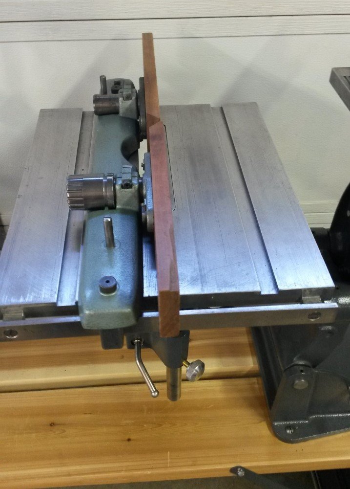

Thank you for adding the pictures. They are a great help in describing things. Shopsmith Mark 5 serial number SS 9405 would have likely been made in 1975. There are no records from that time period, so it is an estimate I have made. Hopefully included in the items you received are the Owner's Manuals for the different tools.
You asked,
JPG answered about the Jig Saw Blades. As for the Shaper/Router Attachment if you mean the fence there is a picture of that below. It is the one for the original Table System but also fits on the Model 10E and 10ER shown mounted in the picture.
_
- Shaper Fence P-N 11 700 on 10ER.jpg (108.17 KiB) Viewed 10352 times
If you are referring to the Shaper Cutters and Router Bits themselves, they use an arbor/spindle for the Shaper Cutters and a Chuck for the Router Bits.
