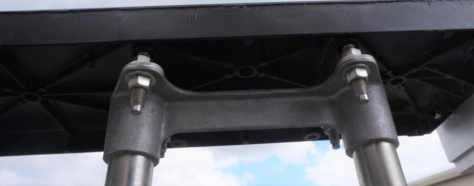

Posting pictures of the problem you are having will be helpful. If I understand your problem correctly, just like the Model 500 original tables there is a greater distance from the front of the table to the mounting on the Extension Table Base. There is a difference between the front Fence Rail Extrusions and the rear ones. The Fence Rail Extrusions mount to the tables with the same thickness spacer front and back. The 520 Extension Table mounts differently to the Extension Table Base than it does for the Model 500. See the picture below.
Extension Table Mounting.jpg (91.92 KiB) Viewed 12629 times
Notice the nuts above and below the Mounting Base which allows for easier aligning to the Main Table. Model 500 Extension Tables needed to be shimmed between the Mounting Base and the Table casting for alignment.
As an aside (and not that this helps the OP), on a 500 you can remove the bolts and install long-ish studs and nuts as are on the 510/520, then the adjustment no longer requires shims.
