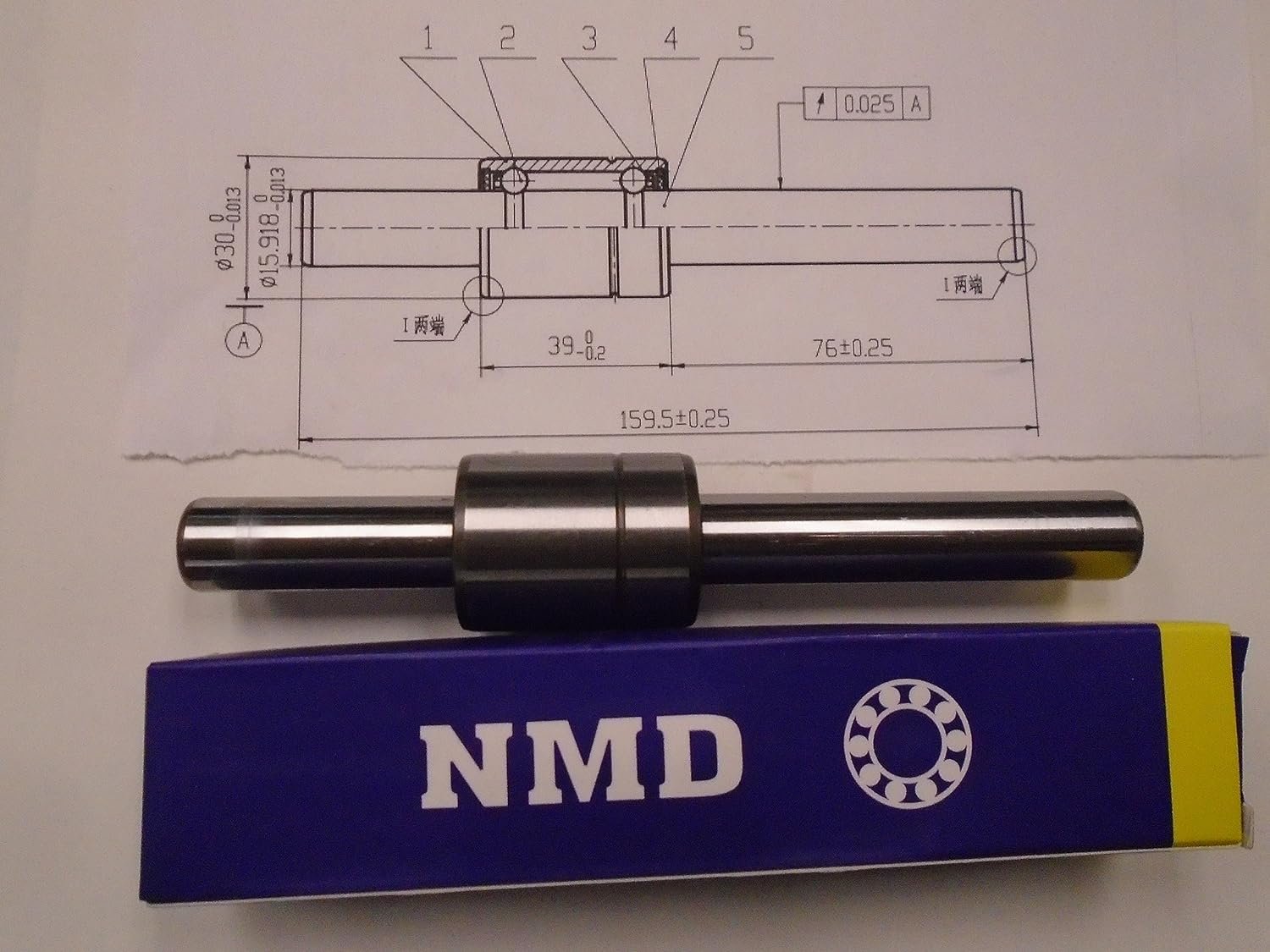

I've never seen a bad idler bearing of the 'early style' so have never attempted disassembly. But edma194 posed a link to a similar assembly without the Shopsmith machining. If you look at the 2D cutaway drawing in the picture it shows that the inner grooves that would typically be part of the inner race are actually machined into the shaft itself. There is no inner race. The bearing isn't separate from the shaft in the typical sense and isn't pressed on. My guess is that the Shopsmith 'water pump style' Idlers are like this.
- David
edma194
Posts: 2205
Re: Mark V maximum idler bearing RPM
Post by edma194 »
DLB wrote: Mon May 20, 2024 4:29 pm I've never seen a bad idler bearing of the 'early style' so have never attempted disassembly. But edma194 posed a link to a similar assembly without the Shopsmith machining. If you look at the 2D cutaway drawing in the picture it shows that the inner grooves that would typically be part of the inner race are actually machined into the shaft itself. There is no inner race. The bearing isn't separate from the shaft in the typical sense and isn't pressed on. My guess is that the Shopsmith 'water pump style' Idlers are like this.
- David
Yes. They are integral units. The shaft is the inner race in this style of bearing. It's a great choice for this purpose, used in the band saw and strip sander also. The shaft length varies for a particular diameter, but other than cutting to length and pressing on a button bearing I don't think Shopsmith does anything else to them. Some are made with two or three rows of balls, some have one row of balls and one row of rollers. They are called waterpump bearings because of their use in automobile water pumps. Other than being sealed bearings I don't know what advantage they offer in water pumps but they are a great way to reduce parts count and simplify assembly.
