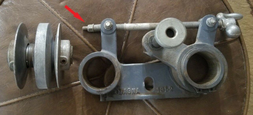

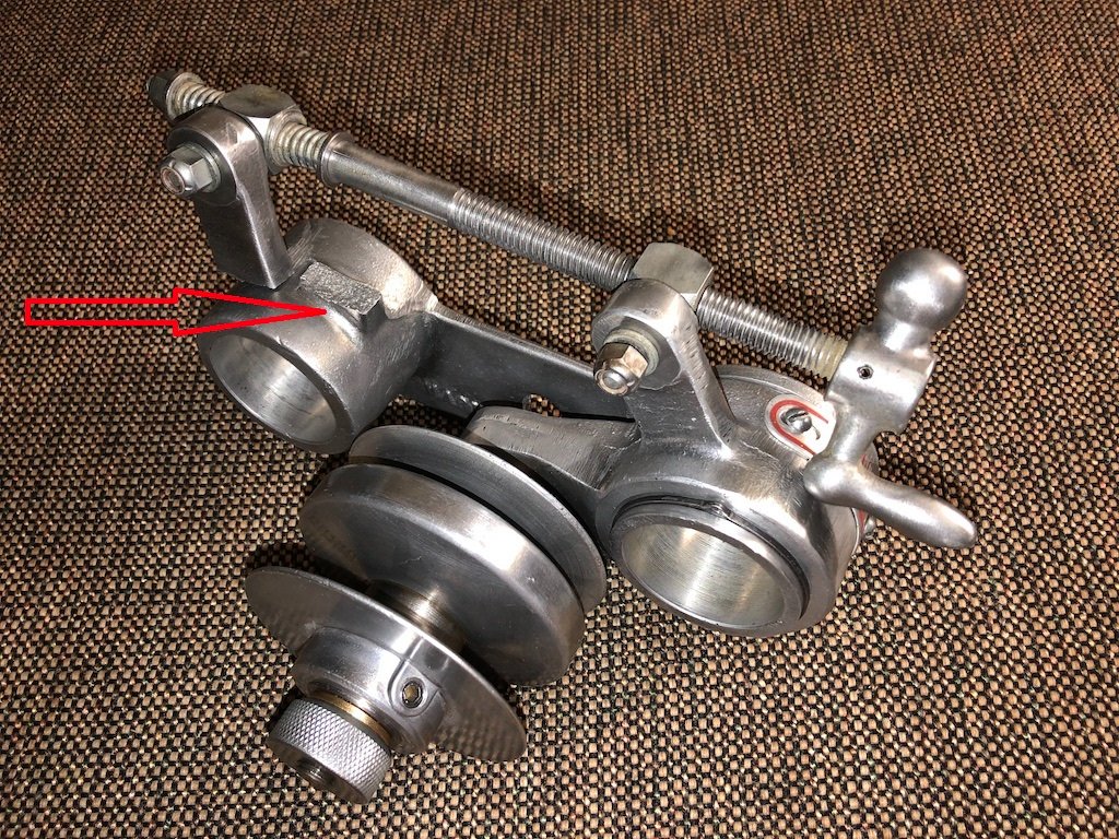

In the picture don1357 posted above the main casting is broken. (see arrow in the copy of his picture below)
Broken Speed Changer don1357 arrow.jpg (337.36 KiB) Viewed 2802 times
The arrow is pointing to the place on the main casting where the "ear" (above the arrow) has broken off. Cranking the Screw Assembly (speed adjustment) handle too far can cause the "ear" to break off the main casting. The handle should never be turned past the point the springs on the back end of the Screw Assembly begin to compress. At that point you will no longer change the speed but will risk damaging the Speed Changer. The lock nut on the end of the Screw Assembly should NOT compress the springs as it is in the example shown below. That nut should be backed off so the springs are not compressed.

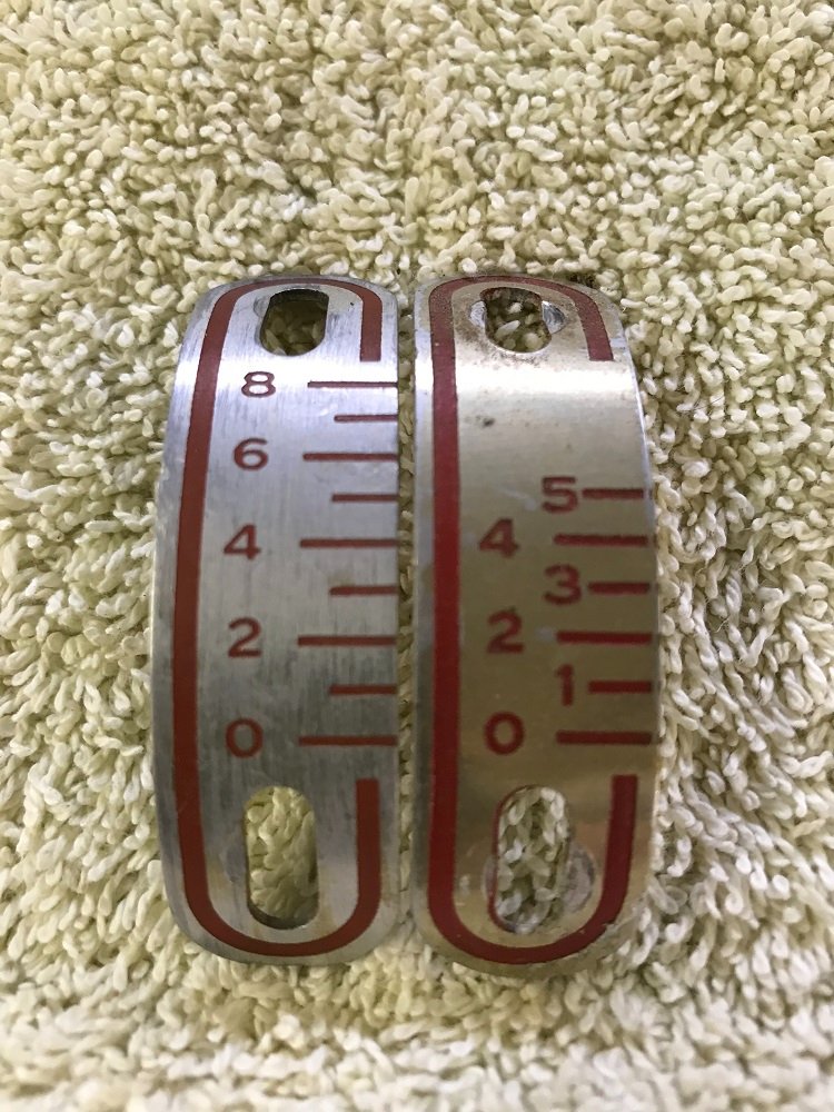

Early Speed Changers had a speed indicator with a 0 to 8 range while later Speed Changers had an indicator with a 0 to 5 range. With either indicator properly set, the speed range is only 0 to 5 and trying to go up to the 6 to 8 range on the early indicator will not increase the speed but will break the casting as shown above. I have no explanation as to why the early indicators had a 0 to 8 range.

The other common breaking point of the main casting is through the center where the set screw goes through to hold it against the Headstock with the nut. The set screw holds the motor mount in the Headstock and should be tight, but the nut is only there to keep the Speed Changer in position against the Headstock. That nut does not need to be tight and if binding occurs while moving the Headstock on the way tubes the Speed Changer Main Casting can break through the middle. See caution in item 18 on page 1 in the PDF manual below.
The problem already discussed in this thread can be avoided by keeping the Floating Pulley Assembly properly lubricated. This includes lubricating the floating center sheave on the sleeve and the Assembly itself (brass bearings) on the shaft of the Pulley Arm. For this a light-weight oil works best and is the easiest to apply. The Pulley Arm needs to be kept lubricated on the Main Casting too. Some dry lubricant can be used on the Screw Assembly threads.

chapmanruss wrote: Fri May 24, 2024 3:19 pm I have no explanation as to why the early indicators had a 0 to 8 range.
…then let’s ask the team at Magna Engineering!
