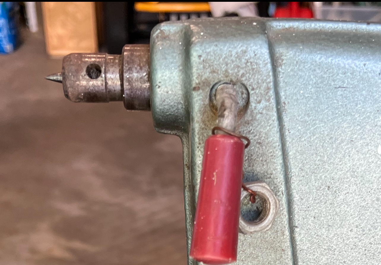

I’m specifically trying to determine if there’s any option other than the dead center on the tailstock side. It appears to be machined from a single piece of metal with the cylindrical portion that slides into the tailstock casting. So I don’t believe there’s an option to pop out the dead center for an MT2-taper live center, for instance. Perhaps the manual would tell me for sure...
(Note the crappy Mark 2-styled handle on this… must’ve saved them about a quarter-cent :mad: )

If it follows the same concept used in this older model Power-Kraft lathe then unfortunately it would be just one single machined piece: http://vintagemachinery.org/pubs/657/2845.pdf
See part number 3050-12 in the diagram. Some other versions that may have copied the tailstock from their metal lathe did use a replaceable center with an MT taper as shown in this video: https://youtu.be/T9ueahldb1w?si=XlIqM-kg6USDdlqq&t=143
