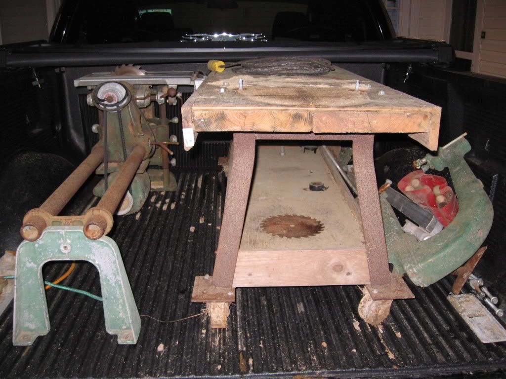

Loaded up in the truck
Link to Hi-Res

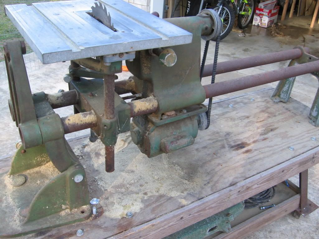

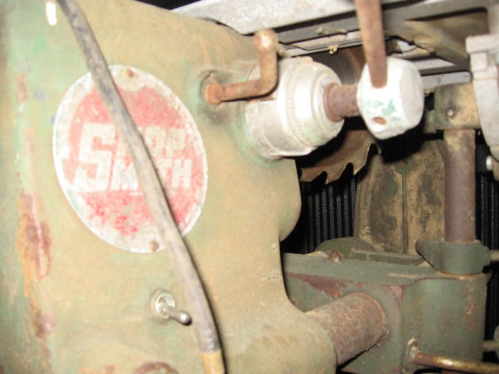

Unused and abused
Link to Hi-Res
Sad state of affairs
Link to Hi-Res

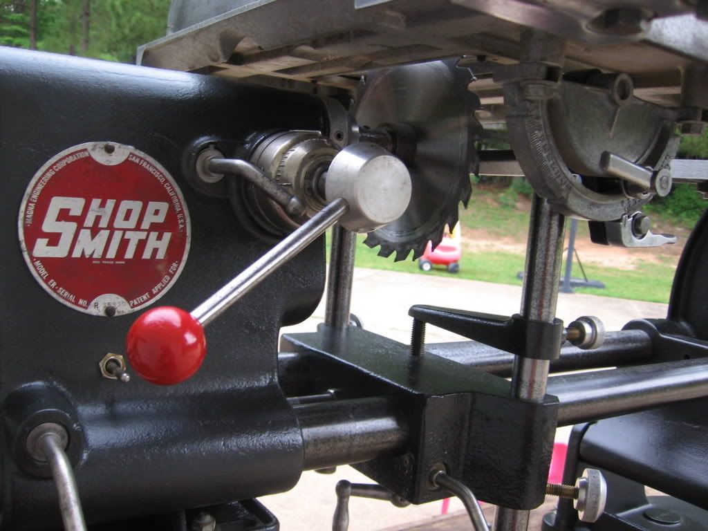

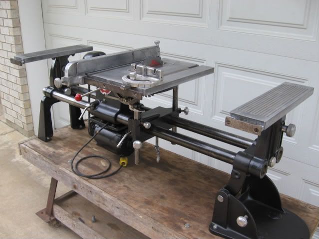

Restored and reassembled
Link to Hi-Res
Link to Hi-Res
Link to Hi-Res
Link to Hi-Res
I've been using my first ER as a drill press since I was missing a lot of the parts. I plan to leave it as a dedicated drill press now. So I put the tailstock and table extension on this ER to extend the table capacity.
I didn't quite go into the level of detail and attention that MickyD did with his Mark V "Greenie" restoration, but I still think it came out pretty decent.

Nice job, the tailstock on the left mounted inside of the tie bar instead of outboard of it is a little unusual. I guess you would have to move the headrest support to the right to allow mounting the tailstock/extension table normally (outboard of the tie bar). Looks great!
