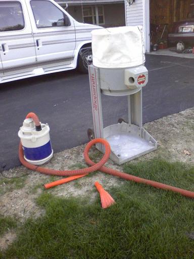

.......and extremely lucky. Saw a post yesterday for a non-functional DC3300. Didn't run. Hadn't run in 2 1/2 years and the owner said he just wanted it gone. $40.00. I figured if I couldn't get it running I could part it out. The former owner said that all it did was hum when it was turned on, so I thought the motor windings were okay. Got it home, took the top bag off. It was dusty, but not overwhelming. Cleaned it up with the shop vac and also pulled some dust out of the vent area next to the switch. The vanes spun freely, no grinding, no stiffness. Plugged it in, hit the switch, it ran. No accessories or hose, but that is the cheap part. Yep, I'm bragging.:D
[ATTACH]4352[/ATTACH]

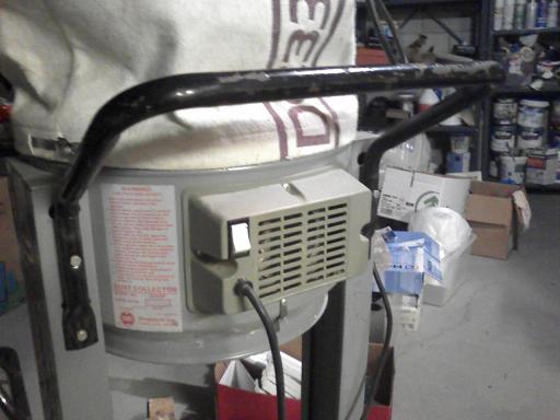

Sorry Guys....Haven't been able to get down to the basement shop until tonight. Took a couple of pics and unscrewed the cover plate. Charlese - Here's the location of the switch.......
[ATTACH]4432[/ATTACH]
I apologize for the mess in the background. The basement shop is in transition (ie., there are no walls, yet )

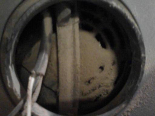

Anyway, that gray box covers the cooling port for the motor. I took that off and this was the view.........
[ATTACH]4433[/ATTACH]
It looked pretty packed in their. And it looked like MDF dust. I sucked out what I could and put it on the major maintenance list.
MickeyD - Since the motor hummed when I turned it on the first time, and then ran after I did the initial cleanup, I suspect the motor got packed with dust, raising the resistance to the point it wouldn't spin on startup. I think I'm going to drag it out of the basement, turn it on and hit it with the compressed air for the short term.

I HOPE that's NOT bare wires I see in the last pic.:eek:
That is a way different switch location from what I'm used to. Also the switch is different than I've seen.
Does anyone know if Shopsmith made motor covers like this, or is it a home made conversion?
charlese wrote:That is a way different switch location from what I'm used to. Also the switch is different than I've seen.
I've never seen one like that either but if it is a home made version the guy who built it was GOOD. Actually, I think that I would prefer this to what I (we) have. I really don't like the connector and exposed wire run on mine.
Check out the wiring real good. Electrical problems that fix themselves tend to worry me!
