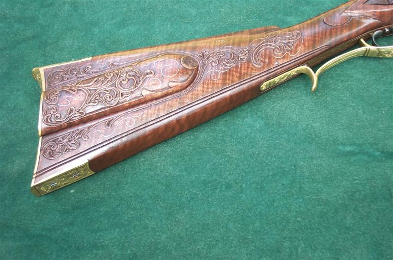

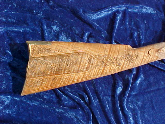

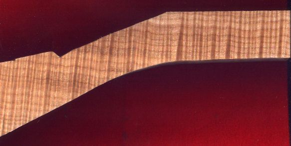

Mark, Here's some pictures that the gunsmith sent me as he was building my 54Cal Lancaster. The first is of the butt section of the rough blank as he received it. It was 3 1/2" thick and roughly 64" long.guitarnut wrote:Hi Tom.

The second photo is of the butt section of the stock after he carved it, but before staining and finishing. There's relief carving and German Silver wire inlays in the stock,and the center section is a sliding wood door patch box. Wood patchboxes were made on rifles before they made the brass hinged door patch boxes. This rifle was made to replicate an early 1700's Lancaster school flintlock.
The third photo is of the same section after the stock was stained and 7 hand-rubbed coats of Tung oil applied. As you can see, the striping is as prominent as the actual grain. (btw, there's not a piece of exposed metal on that rifle that is not engraved, including the screw heads).
