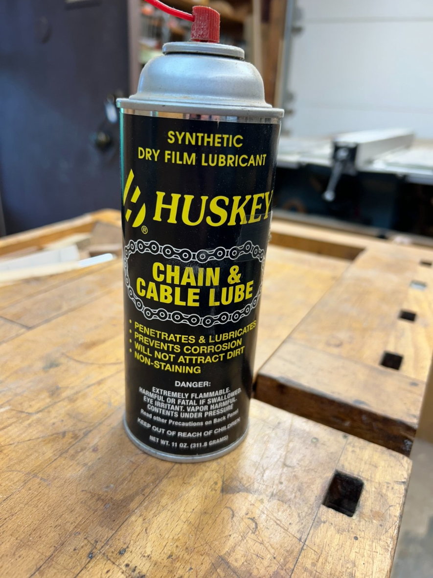

Jim McCann sent me this picture with directions.
"Here is the photo of the dry lube I use on all moving parts of the Planer.
Looking at the can, it is not a graphite product, but it works very well.
The spray tube was included to easily control where this product is applied.
I highly recommend it for the table elevating screws (top, bottom, and threads), the feed roller ends and bushings, the connector nuts, the chain, and the chain tension sprocket axel.
I do not recommend using it on the table. I only use paste wax on the Planer Table
Jim McCann
Engineering, Quality & Customer Repair
Shopsmith LP"
