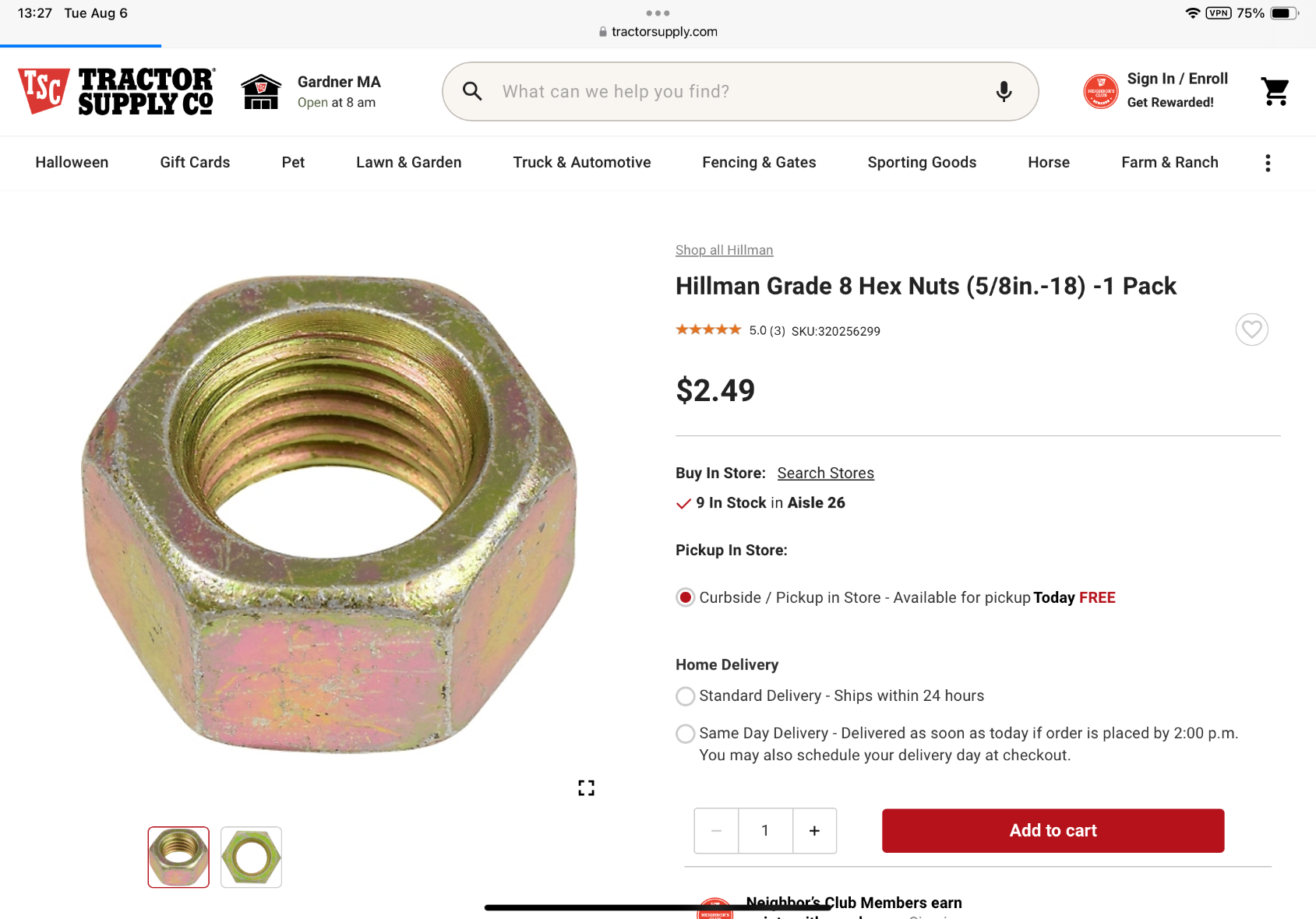

Thanks to all…. I did find a grade 8 5/8x18 at Tractor Supply for about $3.00 each, that will fit what I’m attempting.
THANKS….. Steve….

I over priced it 😉
