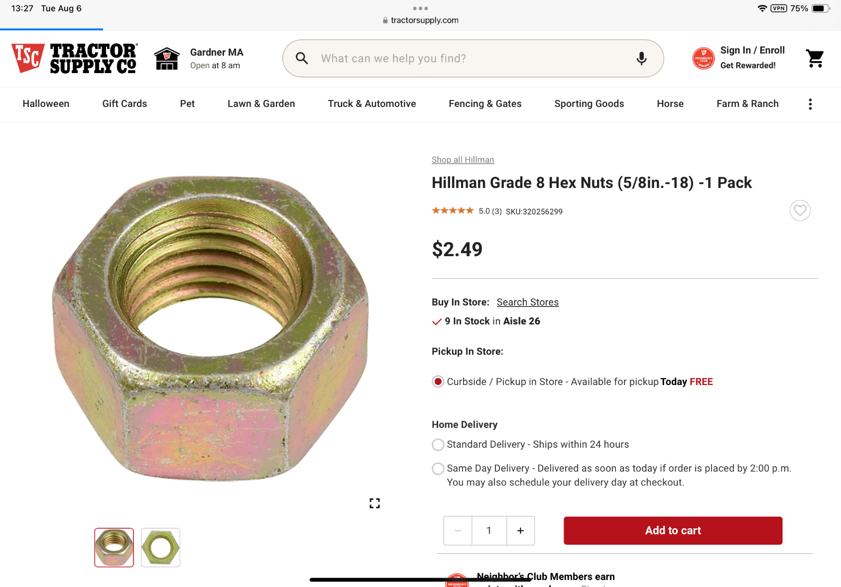

I’m looking to purchase some 5/8 hex nuts that I believe go with the dado arbor.
Does anyone have a part number or a source to pick up a few?
Thanks…. Steve

Yeah, you need one of those special washers with the internal tab. Those nuts (and the shaft) are high grade but fine threaded. If you don't order them from Shopsmith I think you should use a grade 8 fine threaded nut. They're probably not cheap from any source.

Thanks to all…. I did find a grade 8 5/8x18 at Tractor Supply for about $3.00 each, that will fit what I’m attempting.
THANKS….. Steve….

Dang! That is great price. But is it fine threaded? If not i I'd run a tap through it. That weird washer is your locking mechanism.

edma194 wrote: Tue Aug 06, 2024 3:54 pm Dang! That is great price. But is it fine threaded? If not i I'd run a tap through it. That weird washer is your locking mechanism.
Yes it is. I brought the arbor with me and it a perfect fit…

The weird washer is called a spindle washer. It can be found in an automotive store or on Amazon. https://www.amazon.com/gp/product/B000R ... UTF8&psc=1

Looks like a tongued washer to me. ;)
Yes they are used on axle spindles.
