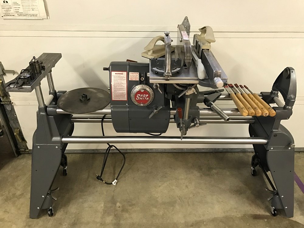

Don't be sorry about the long introduction. We all have a Shopsmith story to tell. It's one of the things that brings us together.
Sounds like you are well on your way to getting your father's Mark V back into great shape. The main concern I see from you is the motor. Since you are taking care if the Fan Sheave issues you may have solved any current motor problem. I have found the motors used in the Shopsmith tools to be very durable and last for decades. Among the many Shopsmith tools I have restored are 2 Shopsmith Model 10E tools from the original ones made with their original A. O. Smith Motors that still work great. They did need a bit of a clean out of dust and debris. The 1957 Mark 5 my wife's uncle gave me recently had a lot of dust come out when I ran the motor but did run fine. The 1982 Mark V I restored several years ago didn't have any problem with the motor. I have yet to have a bad motor in all my restorations. I mention all this to show how dependable the motors used in the Shopsmith tools are. That is not to say they don't ever have problems but try cleaning out all dust and debris from the motor and see how it works before spending money to fix a problem that may not exist.
Poor Table Saw performance may not be the motor but could be a dull saw blade. Worn belts or the upper belt slipping because the tension is too loose is another possibility. The blade stalling with the motor still turning would be an indicator of slippage.
Continue to ask questions here as needed and keep us up to date on your progress.

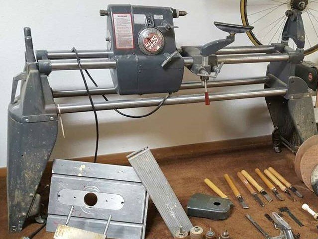

Below is that 1982 Mark V I restored.
_ .
See we all have a story to tell.

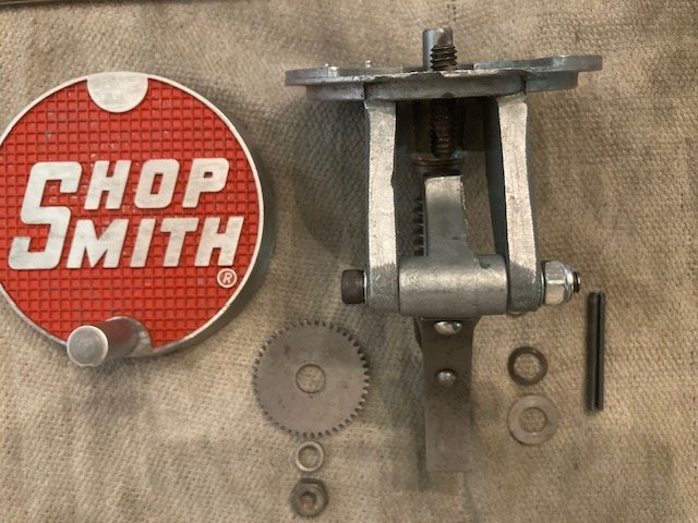

AllenH & JPH,
I'll try to get some pictures tomorrow. I'm pretty bad at that: I get going at it and don't think to take pictures as I go. I should have done some before shots but I didn't think to. I've only snapped a few pictures of the internal mechanisms where I thought I might have trouble remember what sequence it goes together.
As far a progress since my first post, I have it completely stripped down and have mostly been working on sanding and priming the cast aluminum and steel parts. My order from Shopsmith didn't arrive yesterday like I thought it was so I won't be able to try the factory spray paint until it does. Pretty much all the parts are ready for paint. I'll just have rewipe everything down and tape off some the remaining openings to begin painting. I have left a couple of aluminum parts in the original paint just in case I don't like the look of the factory touch-up paint. I have heard others here saying the touch-up paint is too glossy. If it is and I can't tone it down, I plan to take the parts in original paint to a paint shop to try a better match. We'll see...
I did also purchase a used pair of retractable casters from e-bay. That should help from chipping up the bottom while moving the Shopsmith on the concrete floor and inviting more rust to set in which isn't too hard with the humidity here in south Louisiana!
I also bought a spare drive sleeve assembly (Poly-V) with new bearings already installed for $35 on ebay. It already arrived it's a slightly different version of the poly-V drive assembly. It is exactly the same length and fits in the headstock okay. However, the diameter on the Poly-V section (where the set screw is threaded) are different. The original one is 1-5/8" in diameter and the newer one is 1-59/64"I at the same point. I didn't notice the difference when I bought it but it looks to me like they're interchangeable to me. Maybe somebody can confirm that for me? My original drive sleeve assembly is the one on top. The "new" one is on the bottom.
Lastly today, I did the Bill Mayo Speed Control Quadrant modification, replacing the rolled pin attachment with 10-32 screw and lock-nut. I guess the mod is supposed to prevent the arms from spreading over time with the roll pin. I played hell getting the roll pin out. I ended using my motorcycle chain breaking tool to push out the rolled pin: Worked like a charm... once I thought of it! I'll try my hand at posting some pictures of it.

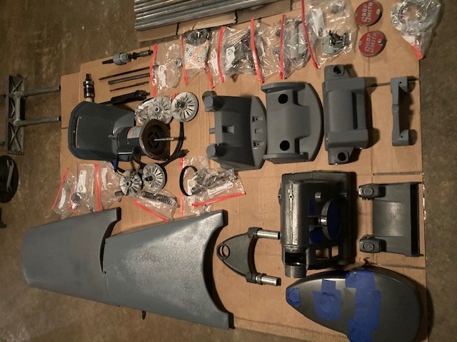

Re: Dad's 1982 Shopsmith Mark V Repair/Restoration Project

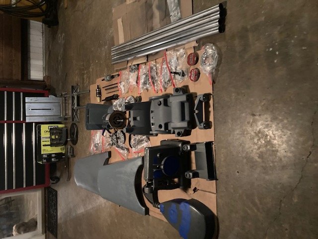

Here's a picture of all parts laid out. SLooks like I still do have a little more prep and priming to do before the paint gets here. Hope it won't be too long so I can start to piece it back together! Sorry the sideways images: the forum software kept flipping my pictures on their side no matter what I did. Also, I apologize for the dark pictures: sun was setting and a storm was rolling in as I took these.
- IMG_9510.jpg (71.43 KiB) Viewed 4084 times
- IMG_9509.jpg (64.66 KiB) Viewed 4084 times

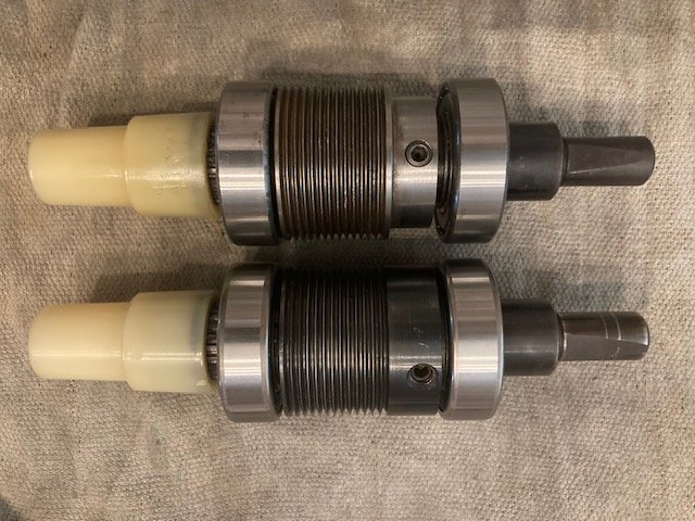

To avoid the 'flipping', ALWAYS take pix in 'LANDSCAPE'' orientation. The forum software ignores orientation in the meta data of the pix.
I am guessing the od measured at the v-groove location is the same on both. That is the only od that matters.
The motor shop needs to be aware that the two bearings have a different inner race id.
Okay, thanks for the help with the pictures. I'll do that next time.JPG wrote: Sat Aug 17, 2024 10:13 pm To avoid the 'flipping', ALWAYS take pix in 'LANDSCAPE'' orientation. The forum software ignores orientation in the meta data of the pix.
Yes, I measure the OD for both of them at 1-29/32".
Interesting information about the different size id on the motor bearings. Glad I didn't buy a set yet. All the motor bearings I've seen up for sale are for a set of two identical sized bearings. Thanks again!
VonZipper,
It looks like you are well on your way in this restoration. You asked me
_ .
As you can see from the picture above the Way and Bench Tubes were in good shape. I believe I only had to clean a bit and wax them.

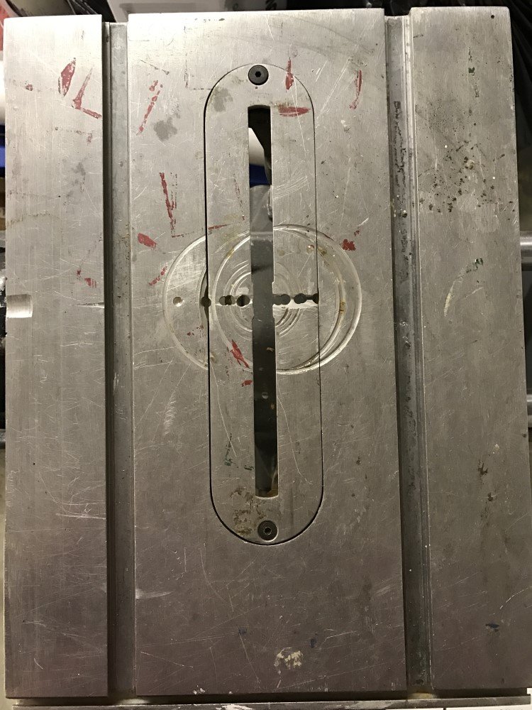

The Main Table was in poor condition as seen below and was replaced.
_ .
The paint I used on it was the Shopsmith gray touch up paint. Three cans of it. You may have noticed when buying the paint there are two formulas of gray paint, one for before 10-01-2001 and one for after. Use the correct formula for best adhesion.
The Caution Label for the Speed Control Warning is a replica I made and have used on other earlier Mark 5's I have restored. It is printed on clear matte finish label stock and in this case it was placed over the silver backing part of the label which was still there. It is below and prints on a standard size 8-1/2" x 11" sheet. There are different page number referenced on the labels of page 2, 4 or 6. This is to correspond to the differences of the warning page of the Owner's Guides.
_
Oh, Wow! That's great! You really made it look new! I wonder what the zip tie on the support tube was for? I had the same zip tie on mine. I cut it off thinking it was something that I or Dad had put on there...
Thanks so much for the caution decal template! I was planning to go to a print shop and try to have them match the pictures I found. But, you've done all the work for me already! All I've got to do is reference my manual to see which version to use! My lable is in the same condition - that is, the silver background of the label is still attached but the wording is completely wiped out. They must have went cheap with the ink in that era. I see a lot of pictures of that particular label in the same condition. Thanks, again!
