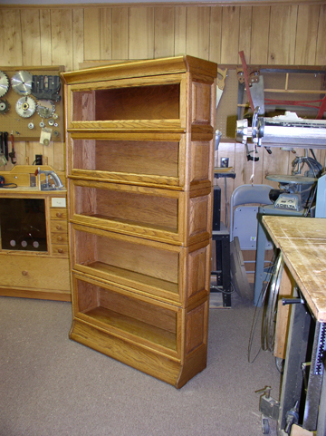

While reading an old copy of Fine Woodworking
I ran across an artical on building the Old style Lawyers,
or Baristers book case. I decided that I would give it a try.
I built my ferst one about four years ago.
I enjoyed the chalenge so much that I thought that
I would build the second one and resize some of the
shelves so that they would accomodate the
Fine Woodworking magazines.
I did a lot of the construction using the SS500.
I am very pleased about the way they both turned out.
I will try to include a few pictures,
Clement Femelat
Raised Panel edited-1.jpg (119.32 KiB) Viewed 3500 times

Very, very nice, Clement. Really like the raised panels, too.

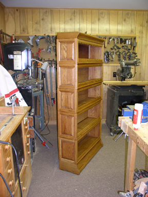

Baristers Book Case #1 Stained.jpg (162.31 KiB) Viewed 3418 times

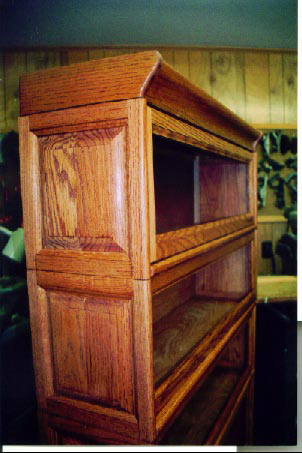

Gene Howe wrote:Very, very nice, Clement. Really like the raised panels, too.
Thanks for the comeback Gene. After seeing the plain cabinet ends on nearly alll Baristers, I decided that It would a lot to the cabinet with a little more detail.
I did all the raised paneling with my Sears Radial arm, with the cutter raised slightly above the table, I was surely covered with a shop full of sawdust.
but after I got into a rhythem, they went pretty fast.
Thanks again for the reply.
