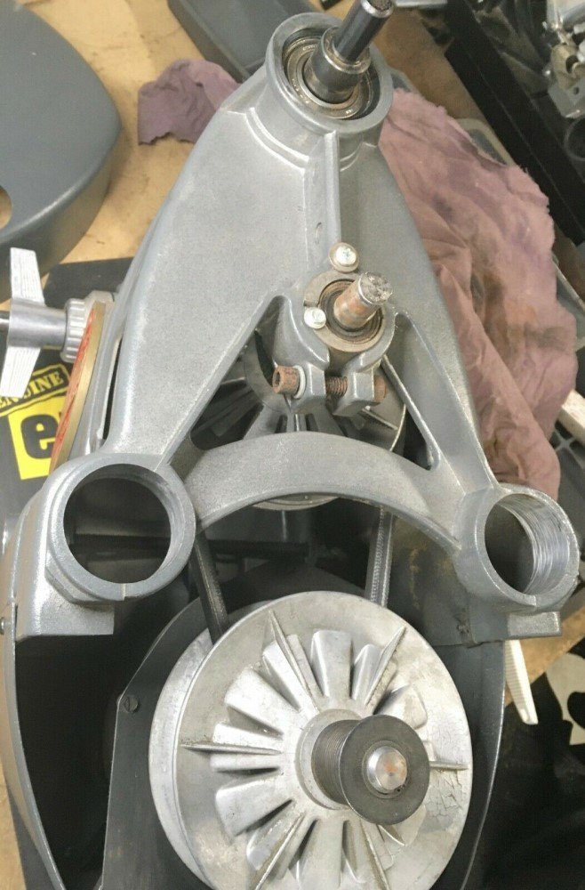

Below is a picture of what you will see inside the Belt Cover on a Conventional Headstock. There have been some differences here over the years so don't be concerned if yours has slight differences.

From top to bottom you can see the Drive Sleeve Assembly end, the Idler Shaft end with the Sheaves behind the Headstock Casting and the Motor and Sheave Assembly at the bottom.

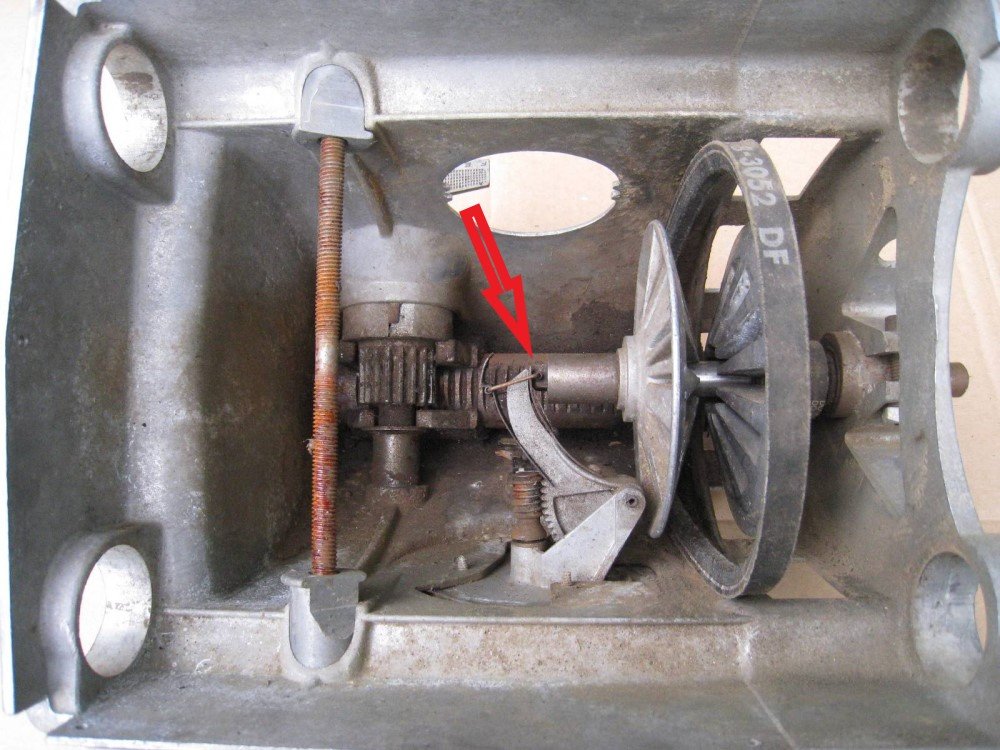

The picture below is looking inside the Headstock casting from the bottom with the Motor and Motor Pan removed. The arrow is pointing the the "connection" between the Speed Control and the movable Sheave of the Idler Shaft Assembly. This is what controls the speed. At the back end of the arrow is the inspection hole previously mentioned where you can see inside without removing the Motor and Pan.

Although not the cleanest the picture shows the parts in their correct positions.
