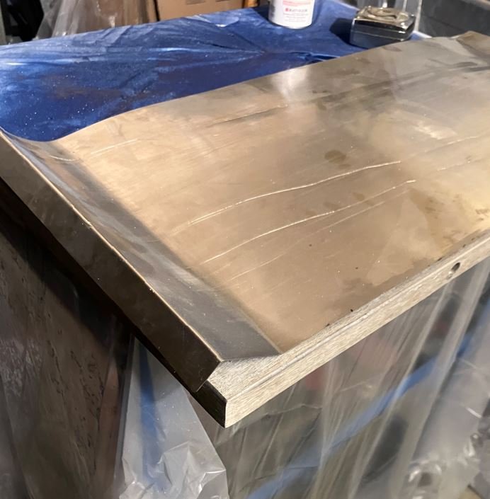

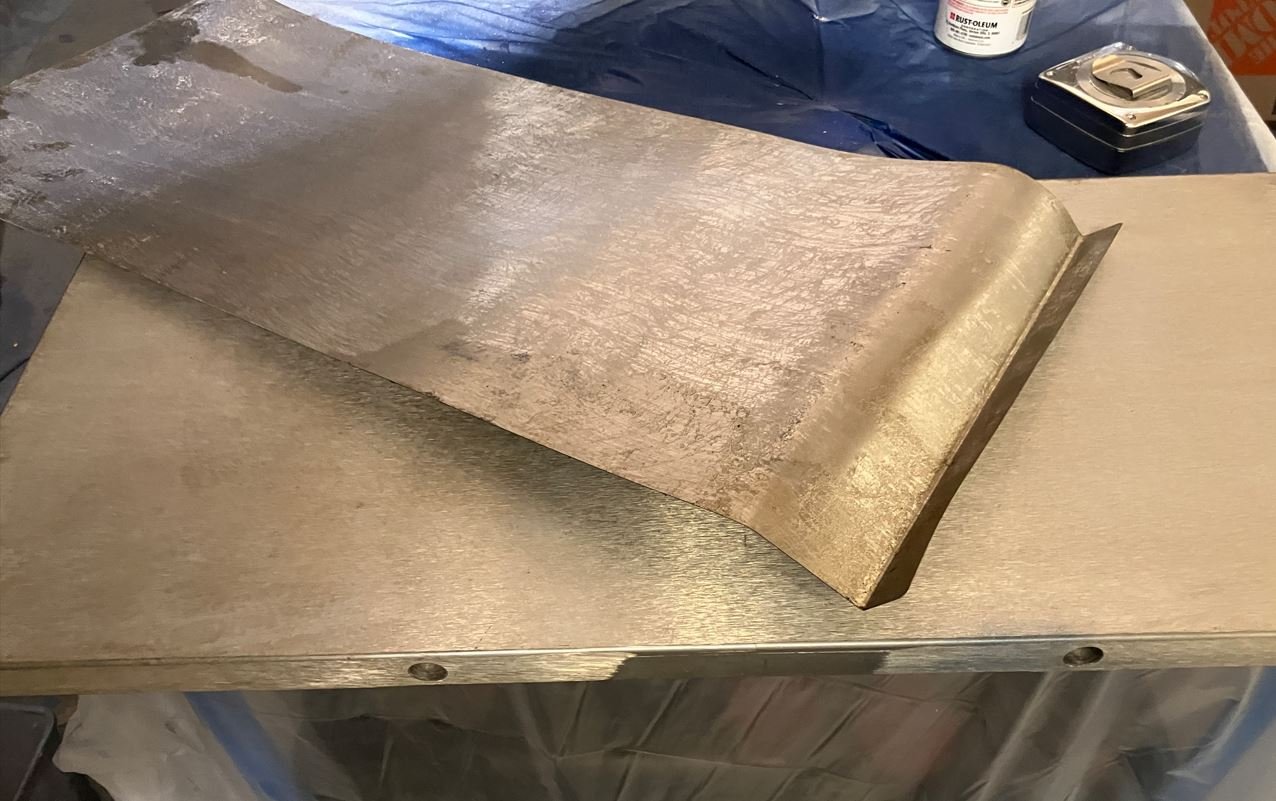

Hi,
which type of glue would be the best to glue a new piece of stainless steel on the aluminum casting bed from the planer?
thanks in advance
Clemens

Glue???
Re: Glue to attach Planer Stainless Steel Clad to Aluminum Casting
It was glue...
- planer table 1.JPG (154.89 KiB) Viewed 2769 times
- planer table 2.JPG (64.42 KiB) Viewed 2769 times
- Posts: 35598
Who pried it off and why?
