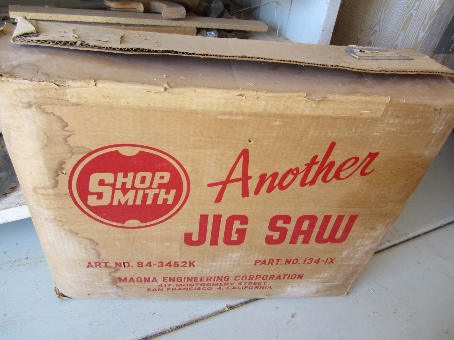

It is helpful to remember that the name Shopsmith was given to the original 5 in 1 Tool the Model 10E followed by the Model 10ER and Mark 5 made by Magna Engineering Corporation. All other tools like the SPT's were Magna tools by name. The exception to that is the A-34 Jig Saw made for the Model 10E and 10ER which has Shopsmith on the gear housing cover and came in the box shown below.

Re: 6" Belt Sander Serial Number/Manufacturing Date Listing
Thanks again, Russ. That's very interesting! It's hard to believe that box has held up so well, too!
