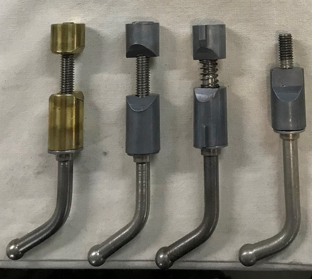

There was a brass Double Wedge Lock version used in the very first Model 10E tools made. You can see the brass wedges below in the different versions of the Quill Locks. Also notice the difference in the bend of the handles between the Quill Locks and the Headstock and Carriage Locks.
_
Quill Locks all versions.jpg (192.91 KiB) Viewed 2063 times

Are you are referring to the picture in my earlier post in this thread with the picture of the different Quill Locks? If so, we can talk about the Double Wedge Locks if those are what you need. I would suggest starting by making sure the holes in the Headstock and Carriage are clean, smooth and waxed. Then try the individual wedges fitting into the Headstock and Carriage holes to determine which wedges need attention. Any not sliding freely into the holes can either be corrected or replaced. The wedges can be filed or sanded down carefully to adjust their fit in the holes if they are binding. You will still need to replace the missing wedge and any that cannot be made usable again.
Anyone with single Wedge Locks making them slide in the Headstock and Carriage lock holes is simpler. The wedge is not a full round one and the slit the handle goes into can widen and need to be closed up a bit for the wedge to fit smoothly into the hole.
For other reading this you should know the picture referenced in this post is a different one showing just the different Quill Locks as shown below. In my previous post in this thread the picture is of the Headstock and Carriage Way Tube Locks. It shows both sides of the single wedge and you can see the slot for the Handle to go through.
_
Quill Locks all versions.jpg (192.91 KiB) Viewed 2037 times

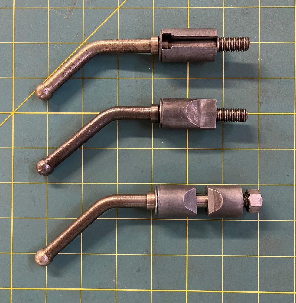

I have also attached an image of my three lock levers.
Regards Peter

Your handles themselves appear to be for the Double Wedge Locks. The Quill Lock can have a larger angled bend but is further out the handle. See the picture below. The handles are a 1/4" with that thread size. The "washers" on yours are different than those I have seen on US made Model 10's. US made Model 10's have a plain washer with an inside diameter hole to fit on the 1/4" Handle shaft and an outside diameter slightly smaller than the wedges.
Here is where it may get tricky. There appears to be some differences between the US made Model 10's and the Australian made Model 10E. I can only give dimensions for US made Model 10's. The Australian Model 10E may be metric dimensions. I measured the Double Wedges and they are 7/8" in diameter. The rear wedge is 7/8" long for all three. The Headstock and Carriage front wedge are 1" long and the Quill front wedge is 1-3/8" long. The most important dimension is the wedge diameter to fit somewhat snug in the lock holes. The length of the wedges can vary slightly as long as their combined length does not exceed the Handles shaft and threaded end. If you are going to have wedges made, I would suggest making them out of brass like the original wedges. The rear wedges themselves can be threaded instead of imbedding a nut.
Below is the Lock Assemblies from my Model 10E and one of the original ones made from 1947. The wedges are brass. The top one is the Quill Lock. The Handles (levers as they are referred to in parts lists) changed somewhat over time. The ones below have more bend to the Headstock and Carriage locks Handles. The two of yours are the more common bend for the Headstock and Carriage locks Handles.
