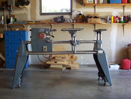

curiousgeorge wrote:It could also be a Woodmaster Multi-Tool. Someone just asked about this machine in another thread. I did a Google search and found some pictures and it is a very close replica of the SS machine.
Here's the Woodmaster Multi-Tool.
[ATTACH]4550[/ATTACH]
- clone.jpg (40.24 KiB) Viewed 7932 times

Yep! That's one I found on the Google search.mickyd wrote:Here's the Woodmaster Multi-Tool.
Maybe ShopSmith could make some $$$ by suing the shorts off the manufacturer of this blatant clone!
