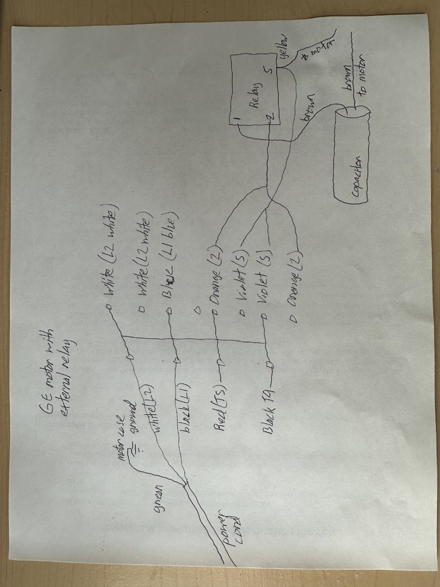

Here is the switch as I currently have it wired:
switch wiring.jpg (138.51 KiB) Viewed 3098 times
The items in ( ) are the original Shopsmith switch locations. I wasn't able to determine what went to the second throw of Black (L1) since my original switch is completely dead.
I wired only one throw first (the top one) for a test, and it worked. Wiring the second (lower) throw as shown resulted in no response at all, not even a hum. I kind of expected that since Black (L1) is open. However, moving Blue (L1 Blue) to the lower throw of Black (L1) also resulted in no response.
I moved Blue (L1 Blue) back to it's original location at the top throw of Black (L1) and now I get only a hum on that throw as well.
Re: Mark VII new switch wiring diagram?
Blue(L1) needs to go to both throws of the second pole(blk L1) similar to the white (L2)
The humming may be due to relay contacts dirt.
Your including the original switch terminal id helps to determine the red/black, violet/orange wiring appears correct.

I tried moving Blue (L1) to the second pole as you described, thinking the same thing, we need a complete circuit through what I assume is the main winding. When I did that, I got nothing at all, no hum or any response.

After further work today, it looks like you were right. I took the relay apart and although clean, it did stick a little. I polished the contact again and cycled it about 20 times. I then installed a jumper between the two throws of Black L1 so it connects to Blue L1 on both throws. After reinstalling everything per the diagram above, it all works now in both directions!
