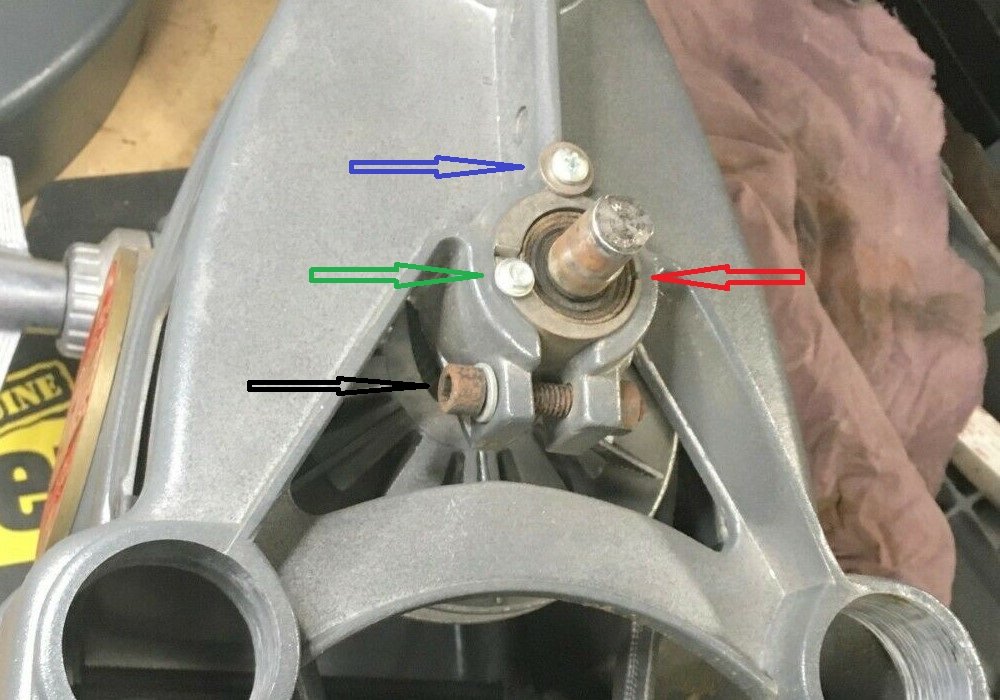

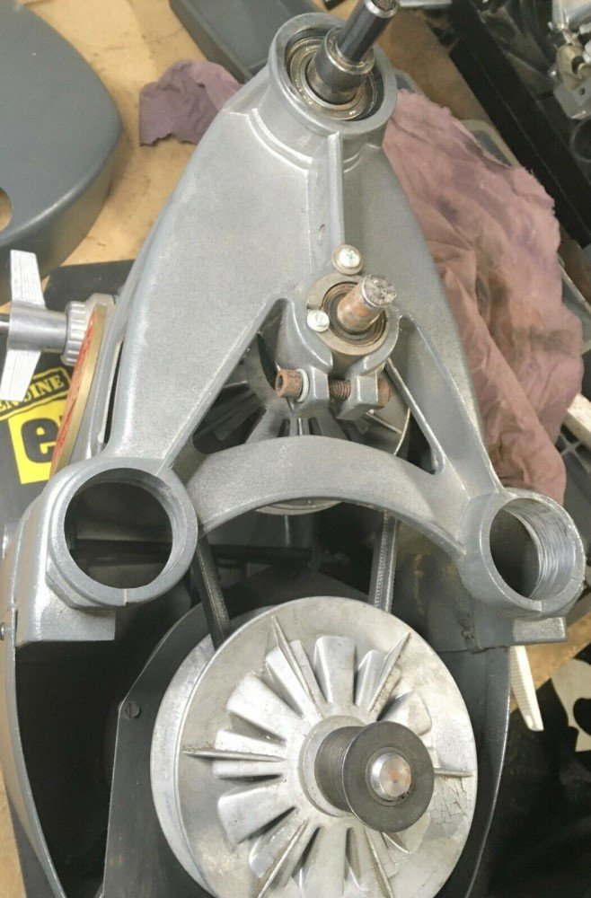

I have to wonder if when removing the lower SPT Drive Hub you moved or possibly damaged the mounting of the Idler Drive Assembly. Do as JPG suggested to make sure the belt isn't bound up in the Motor Sheave. Below is the inside of the Belt Cover. Note the position of the Idler Shaft Assembly (lower Drive Shaft) and the Eccentric in the Headstock Casting mounting point. If yours is not even between the Headstock Mounting and the Idler Shaft Assembly including the Eccentric that could be the problem not being able to turn the Speed Control through the entire range.

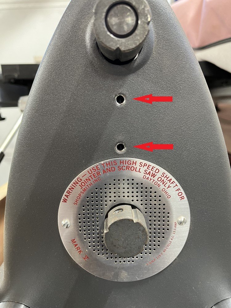

As for the Hub if it now slips on and off easily from the lower Auxiliary Drive (Idler Shaft Assembly) that problem is solved. There are two different size bore Hubs but are for the SPT's themselves. Some SPT's use a 5/8" bore hub while others use a 1/2" bore. Both Auxiliary Drive Shafts on the Headstock are 5/8" in diameter and an example of the Hubs in place is below. Ignore the arrows which point out the holes for mounting the Shaft Guard used for a different post.
_
_ .

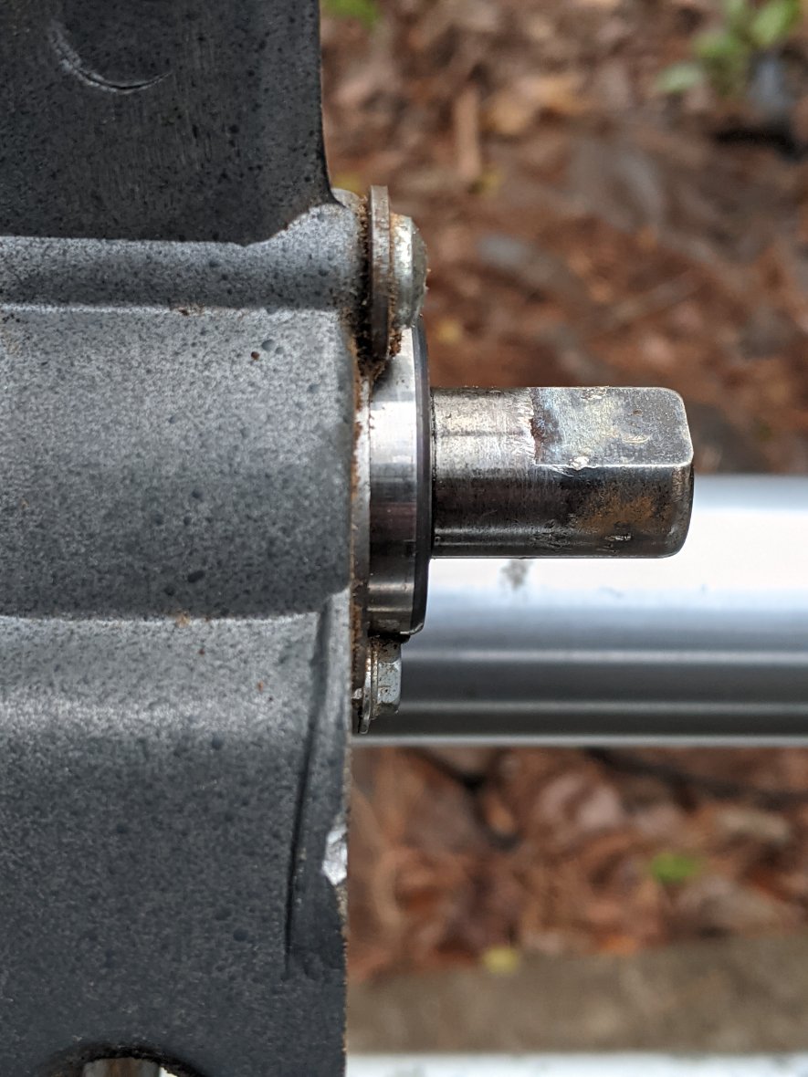

Re: Oooops
Looks like it moved forward quite a bit. I'll check for damage in a little while, gotta do a breakfast run

- Posts: 4538
Re: Oooops

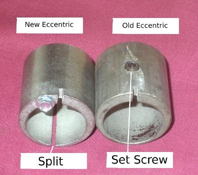

The Idler Shaft Bearing is out past the edge of the Eccentric. That is a problem for adjusting the speed. You will need to remove the Idler Shaft Assembly including the Eccentric from the Headstock Casting and reposition the Eccentric even with the Bearing which is held in place on older Mark V Headstocks with a set screw. If your Mark V is a newer one that does not use a set screw it is the combination of the two screws one on the Headstock Casting and the other on the Eccentric plus the clamping bolt on the Headstock Casting that holds the Idler Shaft Assembly in place. In the picture below is the newer type of Eccentric with the split that does not use a set screw on the left and on the right is the older Eccentric with a set screw to hold it in position on the Bearing.
_ .
Although not shown on the old Eccentric above many have a screw, like the new one, to help hold the position in the Headstock casting. On the newer Eccentric above notice the split is opposite the slot used to turn the Eccentric to adjust the upper Belt tension. If yours has the split (red arrow below) which should be able to be seen without removing the Idler Shaft Assembly you can realign the parts by un-clamping the Cap Screw (black Arrow) on the Headstock Casting, remove the two screws (blue and green arrows) and realign the Bearing and Eccentric even with the Headstock Casting. Re-clamp the Cap Screw and re-install the two screws. If the screw (green arrow) in the Eccentric no longer extends over the Bearing you may want to replace the screw with one that goes past the edge of the Bearing or add a washer to the existing screw. It is partly the clamping of the Cap Screw (black arrow) that holds the Idler Assembly and Eccentric in place. It is important not to over-tighten the Cap Screw to avoid breaking the Headstock Casting. The other two screws (blue and green arrows) also help keep the parts in the proper position.
_
_ .
