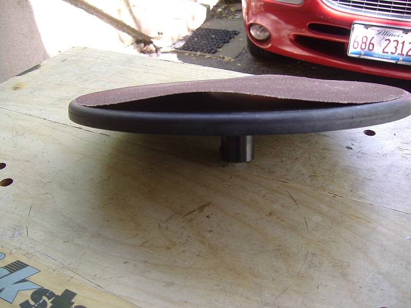

One issue I have had was with the swapping of sandpaper on my conical disk. As you know you should be able to take a grit off and put another girt on and save the original to reuse. I however have and problems doing that.
I've owned my disk for a long while, very shortly after they came out... I normally use the 80 grit and a couple of years back decided to try the grit swapping. Putting the new disk on has never been a problem but when I replaced the old grit back on it decided to fold back and among other things marred my almost new 520 table.
After our discussions and having a good number of people say they were having no problems swapping I went ahead and tried it again last fall. I didn't have a lot of sanding to do but it seemed to be working fine. It has sat since then until yesterday when I was getting ready for a project that could use the conical disk.
When I pulled it down this is what it looked like:
[ATTACH]4578[/ATTACH]
When I lifted the paper I could see the glue was on the paper and the disk had no sticky spots. I removed the paper and found that all told only about 3 places on the disk each about the size of a nickle were sticking to the metal.

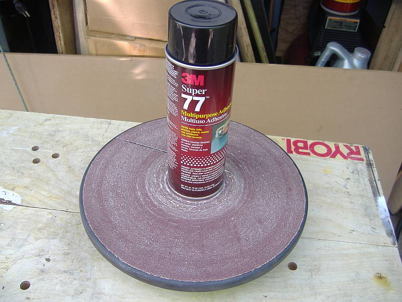

I re-cleaned the disk and added some 3M adhesive. Have to see how this works this time.
[ATTACH]4580[/ATTACH]

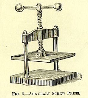

I am reverting back to my old shoe cobbler days for this solution. Even with modern contact cements a good shoe man knows the best way to assure a good bond is to clamp the parts together in a press with a constant even pressure. Consider making a jig with a mirror image depression to match the conical sanding disk. Apply a layer of a firm foam (crepe shoe soling would be about ideal) to the depression. Then not only could you press the sandpaper on the disk when installing it, but you could store the conical disk in the press when not in use and it should always stay stuck together.
You could build a simple press like this one:
http://www.bookbinding.net/amateurs/images/fig4.jpghttp://www.bookbinding.net/amateurs/images/fig4.jpg
but out of wood with the depression made into the base. You wouldn't need or want a huge amount of pressure.
When trying to reapply a used paper to the disk you could place it in the press and heat the disk with a blow dryer or heat gun then let it sit in the press until it cools.
