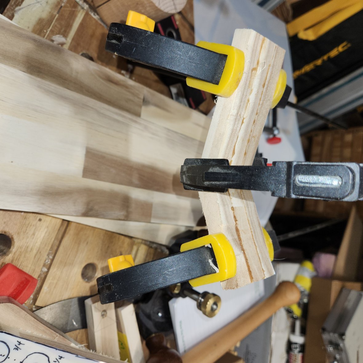

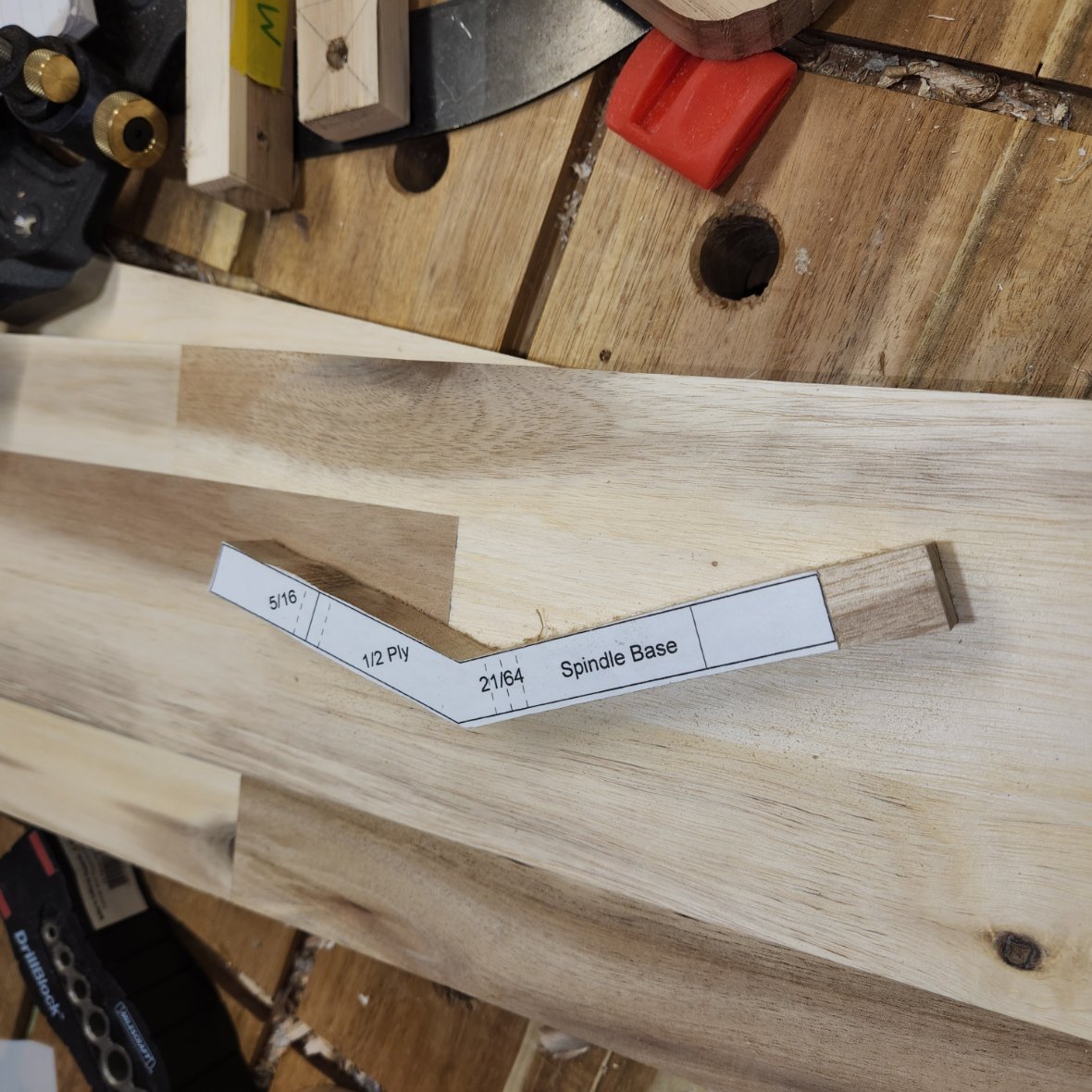

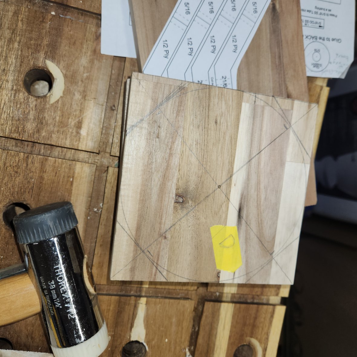

I am going to attempt to make a yarn swift and winder set for my MIL. Has anyone else ever made one of these? I bought plans https://www.lisaboyer.com/Claytonsite/y ... epage.html but am also making some adjustments to them. The person made them for a scroll saw so has multiple pieces made by cutting them out of plywood then stacking and gluing them together. I am going to attempt to make some of them on the lathe instead. Since I do not use the lathe often, we will have to see how they turn out. My husband bought me a couple of glued up 1 x 12 x 4 pieces of Acacia wood that I am using for the non-lathe parts. The boards are closer to 5/8 in thick but I do not see where it will be an issue. I am using hanger bolts and threaded inserts where possible to eliminate hardware that can get lost. I changed the stand set up for the swift to a crossed lap joint. I also replaced the home made clamps with some Milescraft fence style clamps. There was some tear-out from cutting and drilling so am filling as I go before I get to the sanding step.

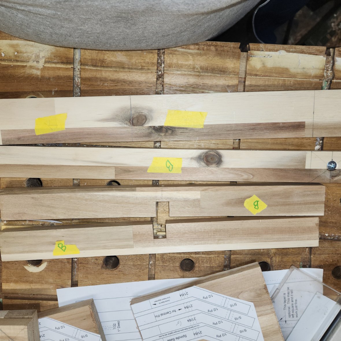

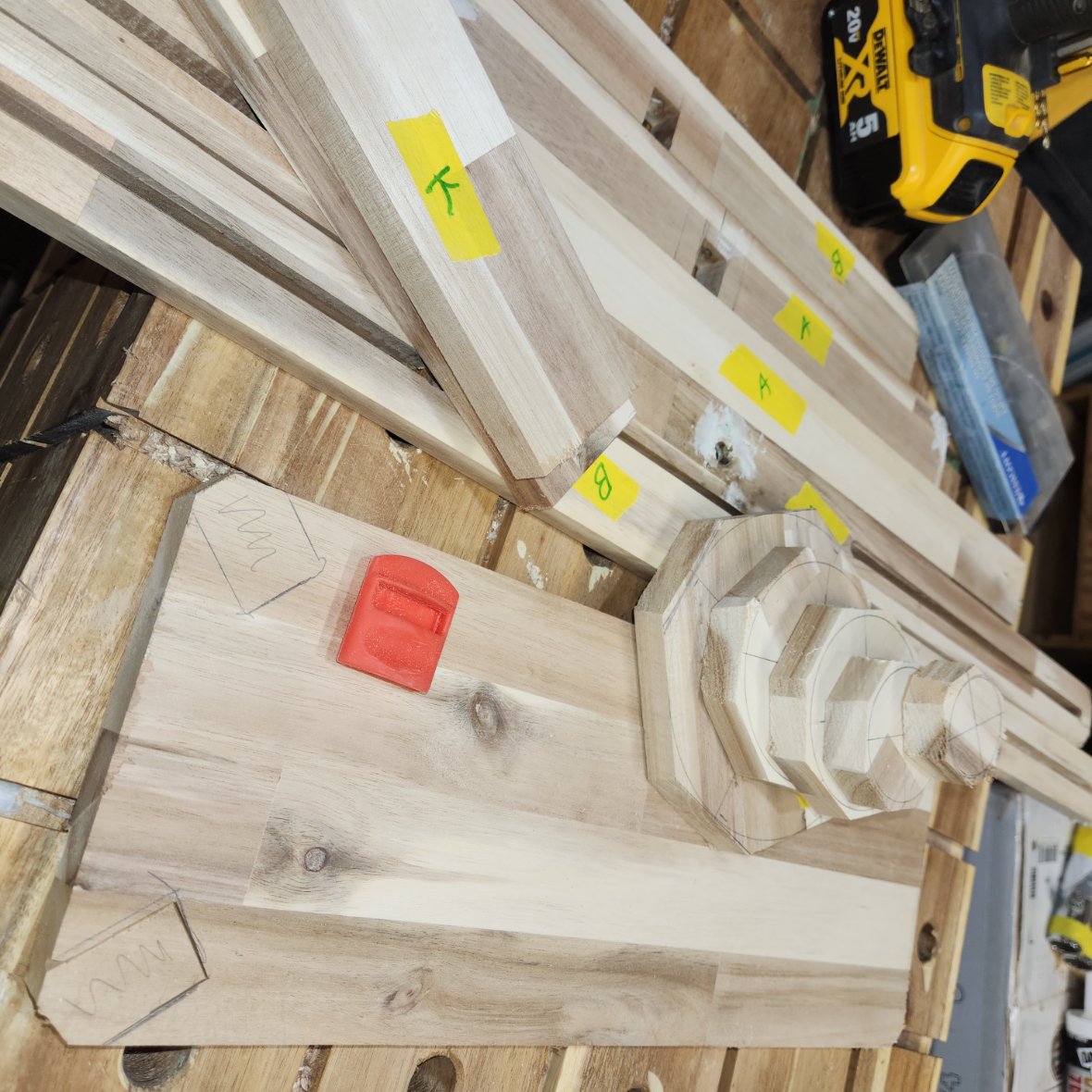

I have gotten the corners clipped on all the parts and the swift parts even rounded on the sanding disk. I have got some of the parts of the swift rough cut to shape and size but plan to sand to final dimensions. It will clean up any of my imperfect cuts. I really need to practice more on my scroll saw.

I decided that I should make one for my mom also so now I'm making two of them. Not really a big deal as it is fairly easy to just double the quantity of parts. While my mom does not do anywhere near the amount of yarn work that my MIL does, it will still come in handy.
Since we have had a couple of really nice weather days this week, I have put two coats of hard wax oil on the swifts minus the handles. I still need to finish up some drilling on the parts for the winders before switching to the lathe to finish parts for the winders and the handles for the swifts.
