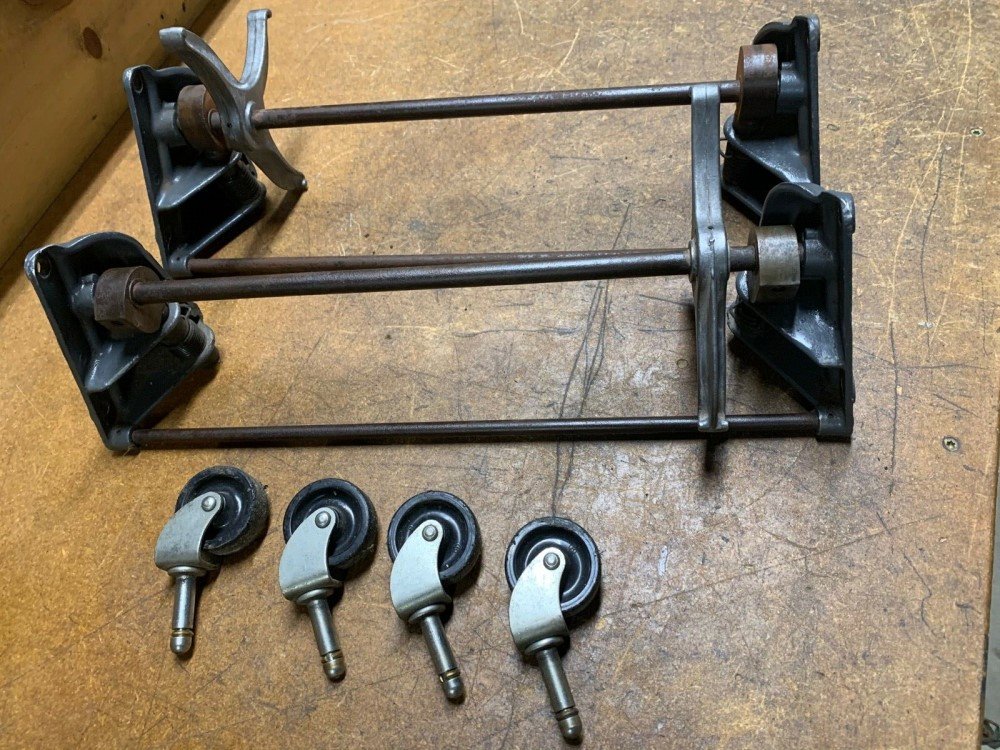

To show what I was talking about yesterday. In upgrading to the 3" Casters for the Retractable Castor Sets the pictures below show the difference between the two for the Foot Pedal location. The first picture is the older version with the Foot Pedal closer to the end of the Drive Rod and the Cam.

The picture below is the newer version which you can see the distance from the Foot Pedal to the Drive Rod end was increased.
_
Retractable Casters - Mark V.jpg (116.91 KiB) Viewed 329733 times
The newer version has enough Foot Pedal clearance to not interfere with the 3" Casters being able to continuously swivel 360 degrees. The design of the 3" Castors having ball bearing swivels put the wheel and frame farther off center. The Shopsmith 3" Casters are shown below. You can compare the difference between the Castors from the pictures above which includes the 2" Castors and 3" Castors below.

To solve the problem some owners have cut off (shortened) the end of the Foot Pedal that interferes with the castor being able to swivel.

The simplest, least expensive and best solution for wheels, if the foot pedal mechanism is working properly but the wheels are bad is this, Shepherd Hardware 9790 2-Inch Swivel Stem Caster, available on Amazon for about $6 each. I have them on three Shopsmith’s and they are great. Just pull the old casters out and push the new ones in. No need to cut or redrill anything. The fit the older mechanisms much better than the 3” wheels.
