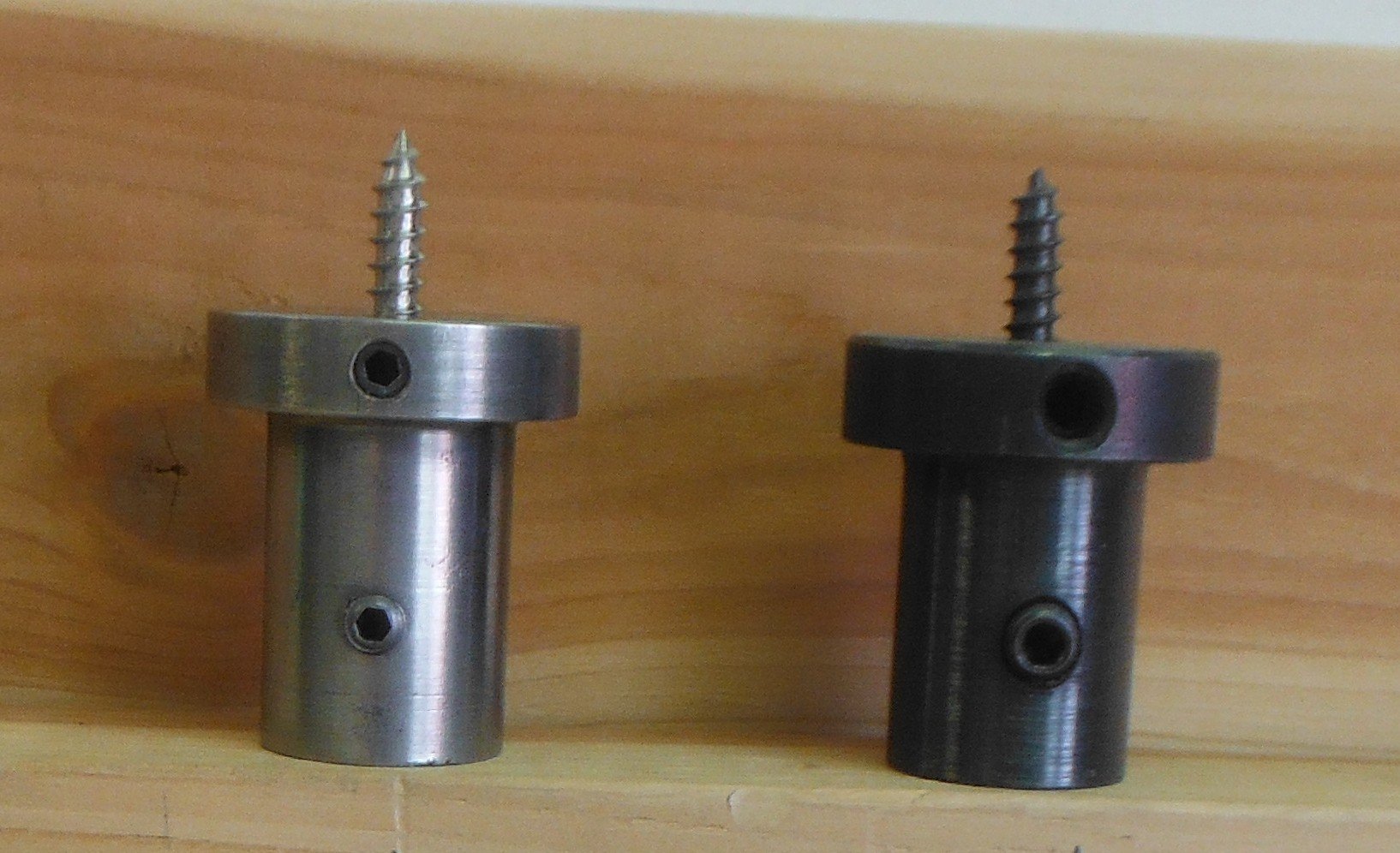

Just a maintenance item for the Lathe Screw Center. If the Wood Screw used for it needs replacing for some reason it is important to get the correct size replacement. It uses a #12 x 1-1/4" long flat head wood screw. Using one that is smaller (#10 or smaller) in diameter will place the screw point off center. A slightly shorter or longer Wood Screw could be used if needed for a particular project.
The picture below is the original (version 1) Lathe Screw Center on the left (part numbers 127-1X & 12 276) and version 3 (part number 505601) on the right.

Version 2 (part number 12 276) would have the same size set screws as version 3 but without the black protective coating. The current version (version 4, P/N 505601) has the larger diameter base as seen below.
