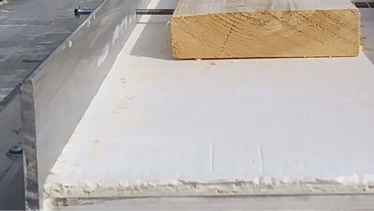

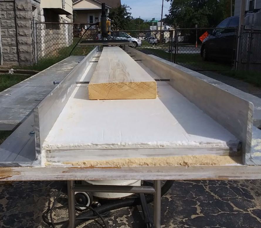

See attached photos.
The 'trick" is to hold the workpiece in place without distorting it. This is done by running "setscrews" into both sides of the board.
The "setscrews" hold the workpiece securely during the cut, with no distortion.

A long time ago I learned the acronym FEET as a way to keep track of how to mill a board. The first F is for Face...flatten one face and mark it as a reference surface. As has been discussed, there are many ways to get this first step done. Hand plane and winding sticks was the "go to" method for centuries, which still works, but router sleds, (btw, Steve, those "set screws" are a clever way to hold the stock in your sled ) planer sleds etc as already discussed can get the job done. The chosen method depends on the size of the work piece and/or how many pieces need to be milled.
