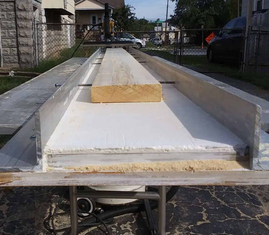

Router sleds are rather slow by comparison to a planer for this same function. Also wonder how the economy works regarding router bit vs. jointer/planer knives. Much easier to sharpen jointer/planer knives than router bits. Most of us see router sleds as being useful for making slabs and they have a niche for example with producing live edge slabs because you want to preserve the sides of the slab. Making straight on all 4 sides lumber is different though. IF you have found a better and faster way to mill lumber using a router sled, I am sure we would all like to hear it. Also what do you do about warped lumber? It must be clamped in some fashion to keep it from moving as the sled is moved across the workpiece - otherwise planarity will elude you. There is a reason that when you want an S4S board that the standard woodworking method is jointer + planer (optionally + table saw) for hundreds of years.
Re: question about planers
Posted: Thu Mar 27, 2025 1:01 pm

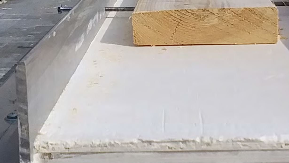

by SteveMaryland
See attached photos.
The 'trick" is to hold the workpiece in place without distorting it. This is done by running "setscrews" into both sides of the board.
The "setscrews" hold the workpiece securely during the cut, with no distortion.
sled 1.JPG (125.03 KiB) Viewed 166040 times
sled 2.JPG (71.17 KiB) Viewed 166040 times

SteveMaryland wrote: Thu Mar 27, 2025 8:47 am
So I guess the ideal "3 machine" combo is: router sled + planer + table saw. Forget the jointer. Stumpy's video makes this point.
I'll just put in a quick good word for the SS jointer here.
A long time ago I learned the acronym FEET as a way to keep track of how to mill a board. The first F is for Face...flatten one face and mark it as a reference surface. As has been discussed, there are many ways to get this first step done. Hand plane and winding sticks was the "go to" method for centuries, which still works, but router sleds, (btw, Steve, those "set screws" are a clever way to hold the stock in your sled ) planer sleds etc as already discussed can get the job done. The chosen method depends on the size of the work piece and/or how many pieces need to be milled.
