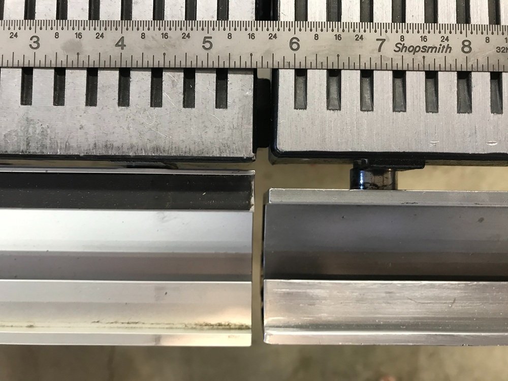

One more thing since you mentioned the scale. Early 520's don't have the scale and all tables have a front (infeed) side extrusion that does not support a scale. (Like most things, there is an upgrade for this.) The scales mount on magnets, that in turn mount on the later version front extrusions. So if this feature is important to you, and you buy used, you'll want t select a set that includes the magnets. Both versions are sometimes available on ebay.
- David
Posts: 4186
Re: 520 Pro VS Mark 7 table/fence Upgrade
Sorry I didn't mention the scales before. Thank to David for bring it up.
The picture below shows the 520 Fence Rails with, on the left the magnet strip for the scale and on the right without.

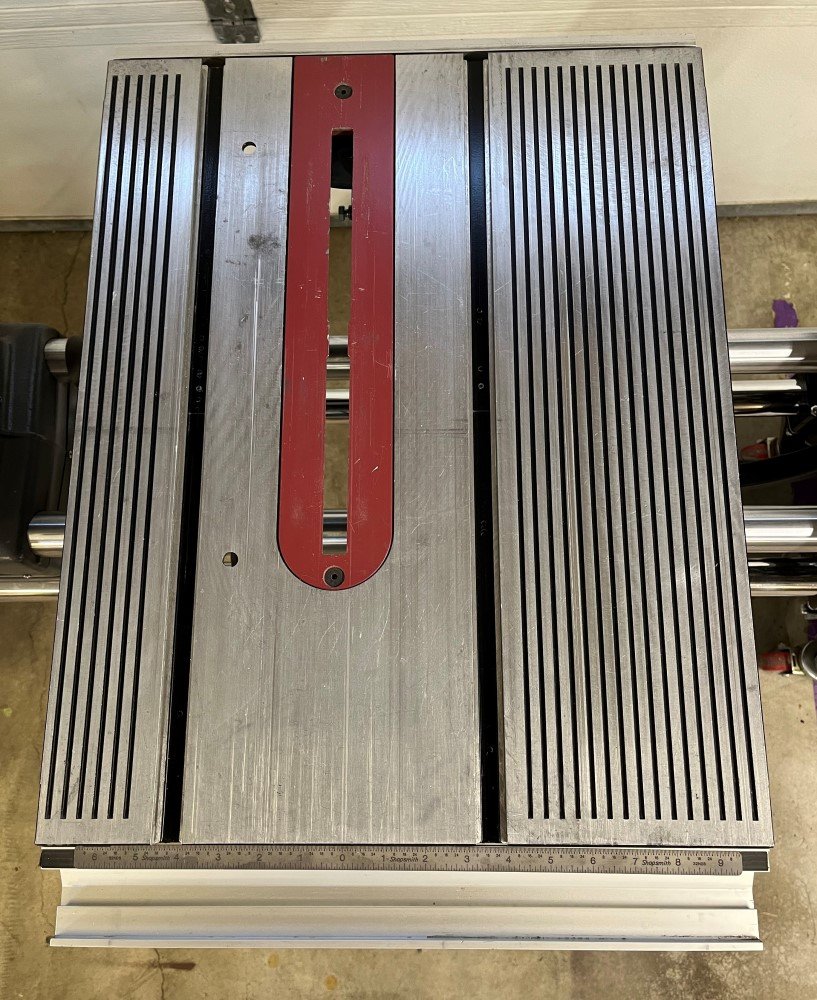

Below you can see the Rip Fence Scale in place on my Mark 7 (same as the Mark V 520) Main Table top.
_
520-M7 Main Table.jpg (212.95 KiB) Viewed 12195 times
There are different length scales some of which can span across the Main Table, Floating Tables, and the Extension Table. The Rip Fence Scales come in different lengths of 9-1/2", 16" and 45" and if I remember correctly there is or was a fourth length.
Although I have this feature on my Mark 7 (which was upgraded from a Mark V) I don't really use it. It has to be aligned to the blade each time the scale is attached to the Fence Rail and since I am going to confirm my measurement with a ruler anyway, I don't bother with the extra step.
