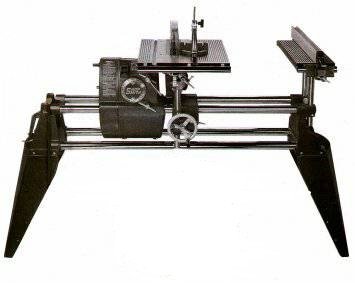

As to the significance of the 510 parts vs. a Mark V 500 it has to do with the model of any given Mark V. Until 1985 when the Mark V 510/505 was introduced there was only one model of Mark V. Up to then was the Mark 5 or Mark V with the original Table/Fence System. When the Mark V 510 and 505 were introduced the original Mark V became the Mark V 500. The pictures below show the different models of the Mark V.

At the same time the Mark V 510 was introduced so was the Mark V 505. This uses the same Table/Fence System as the Mark V 510 but does not have the Floating Tables, Connecting Tubes or Support Legs. Those can be added making it a Mark V 510.

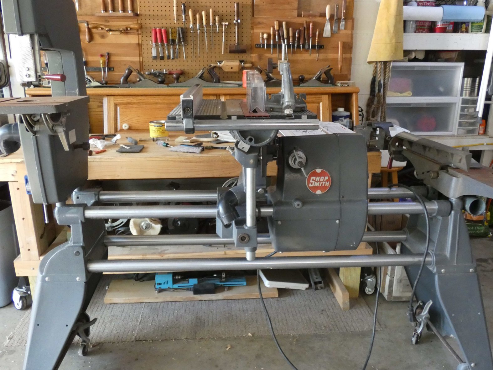

Russ, great advice about doing the maintenance before running it anymore. Did the 50-hour checklist and it's running like supposed to. Now on to the SPTs that came with it, get rid of my Harber Freight devices, and ask the sons-in-law to move it into the work shed for me. Thanks again for all your help. (Data plate is round thin aluminum plate, stamped Mark V, and SS-165571)
Shopsmith Med Qlty.JPG (318.49 KiB) Viewed 71649 times
Re: New member introduction from NE Oklahoma
FWIW, the band saw will not operate on the end shown in the pix. Just a heads up!
Enjoy yer new2you SS.

Posts: 4555
Your Mark V is earlier than first indicated. Serial Number SS165571 was made in December 1983. It's also the reason the Serial Number is on the Vent Plate. The sticker I showed in my previous post only began with Date Coding in December 1987.
The model your Mark V is, based on the Table/Fence System, is 510 or 505 depending on if it has the 2 Floating Tables and related parts which are not shown in the picture. Since your Mark V predated when the Mark V 510 and 505 were introduced yours was upgraded.

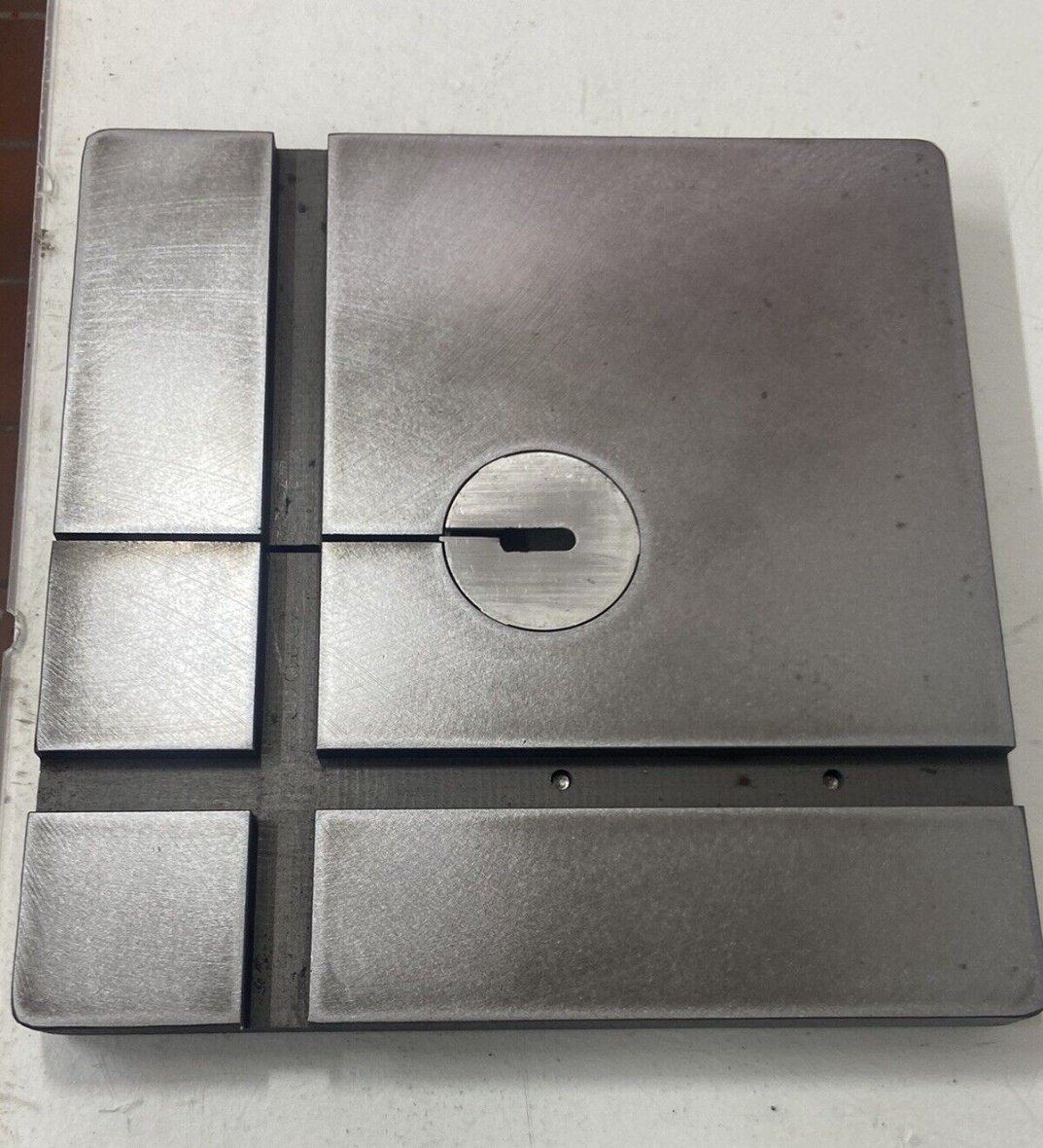

The Bandsaw and Jointer don't look to bad rust wise. I don't see the Table Insert for the Bandsaw in the picture. Hopefully you have it but if not a new one can be purchased from Shopsmith or sometimes can be found used. Currently the Table Insert for Cast Iron Tables part number 502736 is on sale and the original price was $39.95, Sale price is $33.96 saving 15%. The sale price could end at any time. The picture below shows a Cast Iron Bandsaw Table with the Insert.
