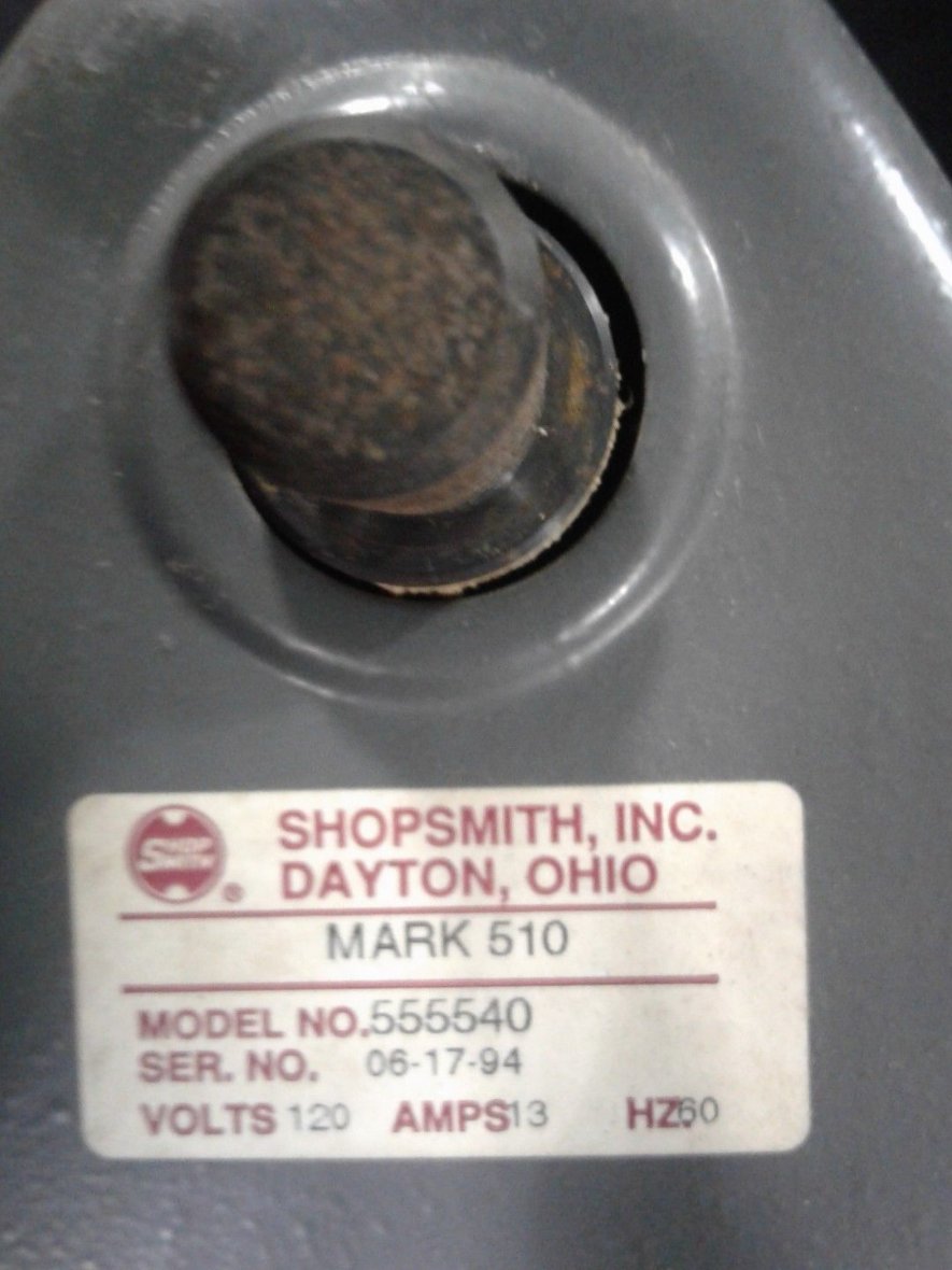

If it is a mid 1990's Mark V you can tell when it was made by looking at the "serial number" on the sticker located on the Belt Cover. For any Mark V made after December 1987 that "serial number" is actually a Date Code of when it was made. Below is an example of the sticker for one made June 17, 1994.

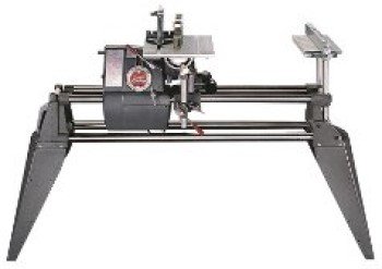

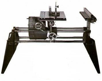

As to the significance of the 510 parts vs. a Mark V 500 it has to do with the model of any given Mark V. Until 1985 when the Mark V 510/505 was introduced there was only one model of Mark V. Up to then was the Mark 5 or Mark V with the original Table/Fence System. When the Mark V 510 and 505 were introduced the original Mark V became the Mark V 500. The pictures below show the different models of the Mark V.
The first is the Mark V 500 with the original Table/Fence System. The Mark 5 originally came out in 1954. It started as Mark 5 but in 1980 the number 5 was replaced with the Roman Numeral V on the tool itself. Mark V had been used in advertising and printed materials as early as the 1970's.
Mark V Model 500 i.jpg (11.94 KiB) Viewed 71990 times

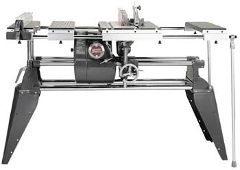

Next is the Mark V 510 introduced in 1985. It has larger tables and adds floating tables for extra work area.

Any Mark 5/V can be upgraded to the other Table/Fence Systems or even downgraded for that matter. I have a Mark 5 Greenie (called that because of it paint colors) from 1957 that has been upgraded to a Mark V 510.
If you have the original aka 500 Table system many 510 parts will not work with it. If your new to you Mark V has been upgraded to a 510 there are parts/accessories from the original/500 Table System that will not work with it.
The Bench, Conventional Headstock and Tailstock are the same on the above Mark V models. The Carriage is different for the Mark V 500 than the other Mark V models. The Upper and Lower Saw Guards made for the original Mark 5/V 500 over the years do not work on the other models. Due to the design of the Upper and Lower Saw Guard for the Mark V 510/505 and 520 longer Saw Blade Arbors and the Sanding Disk Hub are needed. Using the longer Saw Blade Arbors on a Mark V 500 can interfere with some the Lower Saw Guards.

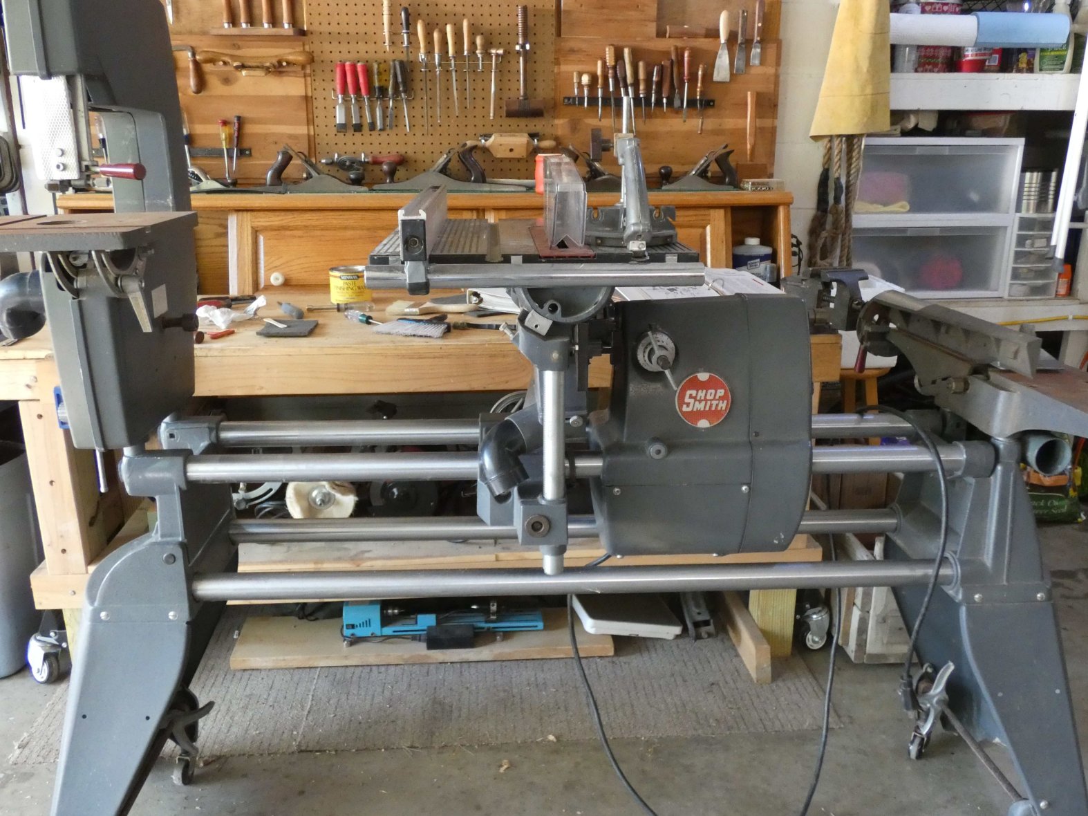

Russ, great advice about doing the maintenance before running it anymore. Did the 50-hour checklist and it's running like supposed to. Now on to the SPTs that came with it, get rid of my Harber Freight devices, and ask the sons-in-law to move it into the work shed for me. Thanks again for all your help. (Data plate is round thin aluminum plate, stamped Mark V, and SS-165571)

Posted: Sat Apr 26, 2025 9:05 pm
by JPG
FWIW, the band saw will not operate on the end shown in the pix. Just a heads up!

Your Mark V is earlier than first indicated. Serial Number SS165571 was made in December 1983. It's also the reason the Serial Number is on the Vent Plate. The sticker I showed in my previous post only began with Date Coding in December 1987.
The model your Mark V is, based on the Table/Fence System, is 510 or 505 depending on if it has the 2 Floating Tables and related parts which are not shown in the picture. Since your Mark V predated when the Mark V 510 and 505 were introduced yours was upgraded.

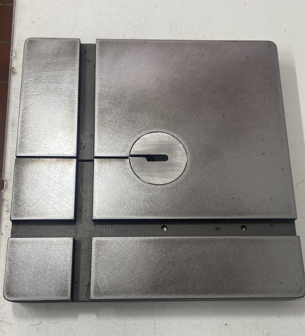

The Bandsaw and Jointer don't look to bad rust wise. I don't see the Table Insert for the Bandsaw in the picture. Hopefully you have it but if not a new one can be purchased from Shopsmith or sometimes can be found used. Currently the Table Insert for Cast Iron Tables part number 502736 is on sale and the original price was $39.95, Sale price is $33.96 saving 15%. The sale price could end at any time. The picture below shows a Cast Iron Bandsaw Table with the Insert.
_
CI Bandsaw Table with Insert.jpg (207.65 KiB) Viewed 71002 times

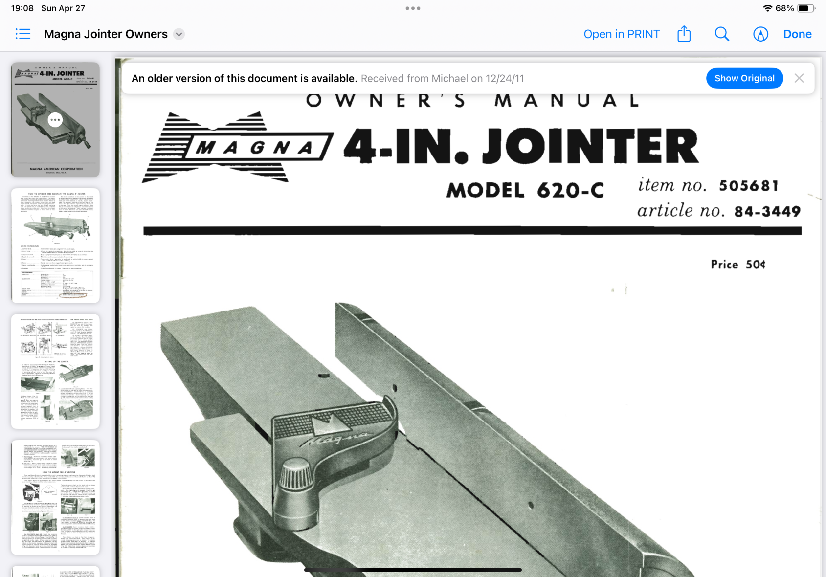

If you didn't get the Owner's Manual for the Cast Iron Table Bandsaw a PDF copy can be downloaded from here on the Shopsmith website at the link below.
https://www.shopsmith.com/_files/ugd/d5 ... 7d45c6.pdf
Unfortunately, the Jointer Manual (part number 556076) is not currently available for download or purchase. If you need one, we can help find a PDF for you to download from somewhere.

chapmanruss wrote: Sun Apr 27, 2025 12:37 pm
I don’t know if this will help (different model #) I’ve got a PDF but it’s too large to attach here. If needed I’ll need some assistance in posting / making it available…
Steve

by chapmanruss
Steve,
That PDF of the 1964 Jointer Manual is available through the Forum on Everett's Google Drive along with many other manuals that he has restored and made available to us. They can be found in the Maintenance and Repair section under the topic Shopsmith Large format Drawings, Illustrations and more which will be found near the top of the page. Once there click on the My Google Drive link.
StoneyD,
Although the 1964 Jointer Manual may be earlier than your Jointer was made not much changed with the Jointer from then until 1984. That is when the Jointer Infeed Stop was added. Other later additions include the current Cutter Head, Feather Guard, Pulley Guard, Rear Cutter Guard and Chip Chute. Any of those changes can be added to any of the earlier Jointers with the exception of the Infeed Stop (requires cast on part on the Main Jointer Assembly, base outfeed table) and the Chip Chute cannot be used on the Model 4E Jointer. Operation, Alignment and Maintenance are basically the same.
