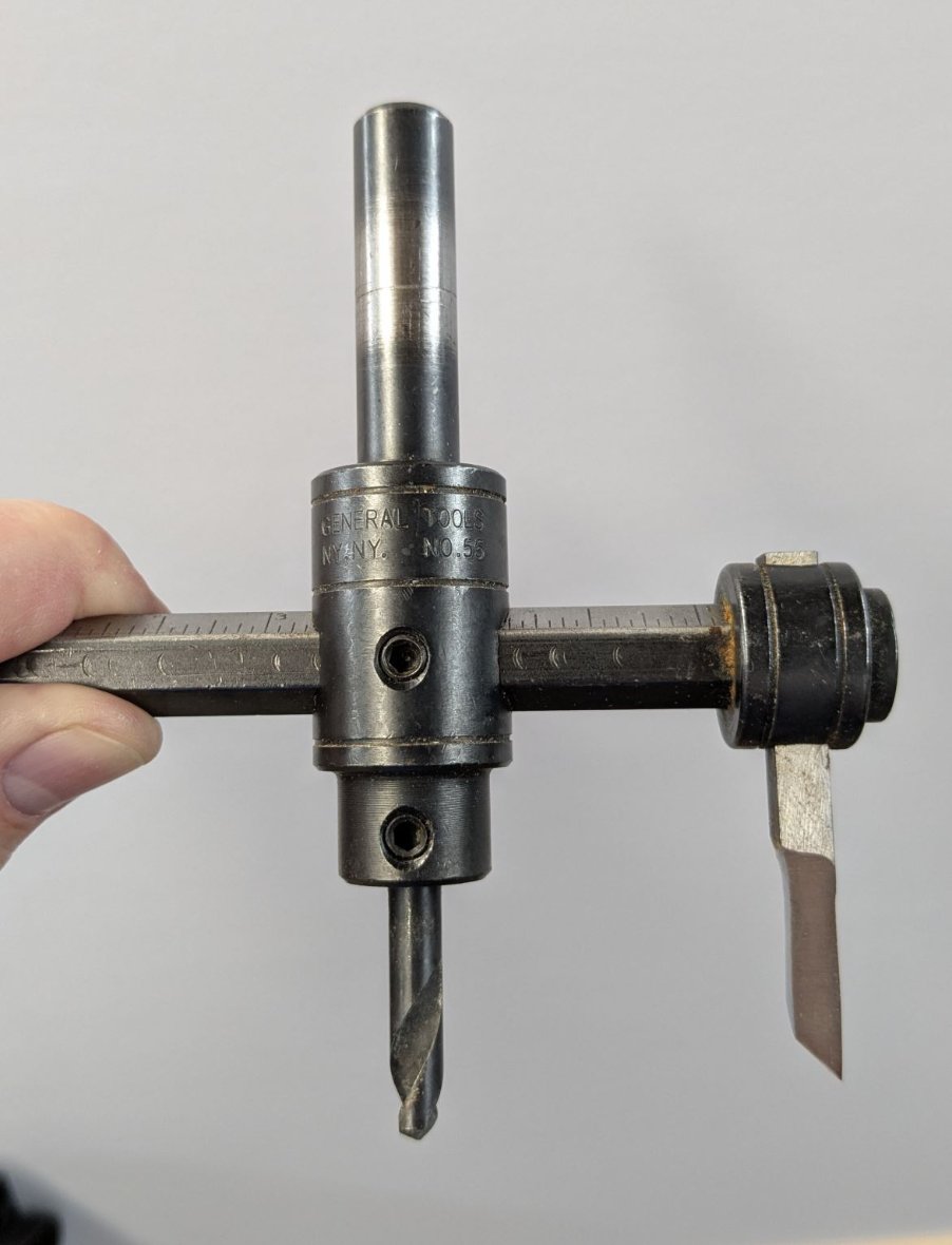

Are you talking about something like this General 55 Circle Cutter?
Hole cutter.jpg (59.53 KiB) Viewed 116247 times
I have one of those, and it didn't work well out of the box. I finally realized that the cutter had no relief angle ground on it, so it would rub and burn while cutting, which undoubtedly required excessive torque. So I reground the cutter to add relief and a sharp edge, and after that it worked well.
I will say, however, that I wouldn't use it chucked directly to a conventional headstock,as they just don't have a low enough speed IMO. The General Tools product page says "Only safe to use with drill press running at less than 500 rpm". And that still seems awfully fast if the cutter is extended more than halfway. When I use mine, I always use it with my SS Speed Reducer.
I also use one of my Jacobs 3326 chucks, each of which was acquired along with a 10E or a 10ER. They seem to be a more precise, robust chuck than the later ones from Shopsmith, and they can handle my circle cutter without issue.

BuckeyeDennis wrote: Thu May 01, 2025 2:11 pm Are you talking about something like this General 55 Circle Cutter?
Yes - that’s exactly the one I’ve got. I’m running it on a PowerPro headstock so getting the low rpm isn’t a problem. Mine doesn’t burn when it cuts and it seems pretty sharp. It just binds and slips occasionally. What does your cutter look like now that you’ve added a relief angle?
- Matanuska
1984 Mark V upgraded to 520 PowerPro. Shopsmith cast iron table bandsaw, jointer, belt sander, and 60's vintage 610 jigsaw SPT's. Makita 2040 15" planer, JessEm Mast-R-Lift II router table.
Posts: 3812
Re: 5/8 Inch Keyless Drill Chuck

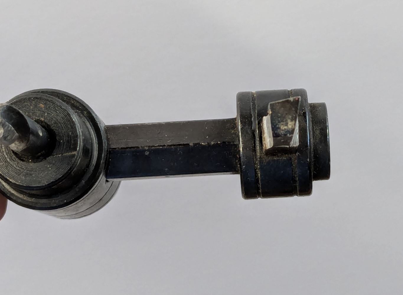

As you can see from the first photo, I had also had some problems with mine slipping in the chuck, all before I ground relief angles on the bit, IIRC.
The idea is to grind back the non-cutting flanks of the bit at an angle, so that only the cutting edges contacts the workpiece. I also reverse-tapered it a little from the tip back up to the shank, as all the cutting should happen near the tip. Any contact higher up is just rubbing.
I ground it freehand on a belt sander, so it's not the prettiest, but now the bit cuts free and clean. In hindsight, I probably didn't need to grind the front face of the bit -- leaving it flat should be fine.

If you do only a single grind, it should probably be on the inside face of the cutter. Otherwise the inside cutting arc, which is defined by the radius from the spindle axis to the front cutting edge of the bit, passes right through the inside face of the cutter. Just imagine making a top-view drawing of that arc with a compass, with the cross section of the square cutter exaggerated. That pretty much guarantees heavy rubbing on the ID of the cut.
Oh I think under cutting behind ALL cutting edges is best.
The front face is not radial to the center.(it leads a radius)
