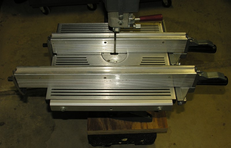

Dusty is correct if you just try and mount the 500 fence to the bandsaw without shortening it to fit. The 500 upgrade fence is just a bit longer than the bandsaw fence. It is not hard to modify the 500 fence, but it is a lot easier to just order the correct one from SS.dusty wrote:Farley, none of the 500,510,520 fences are compatible to the SS Bandsaw unfortunately.

[ATTACH]4741[/ATTACH]
- Fence.JPG (88.98 KiB) Viewed 7378 times

The later versions of the bandsaw fence have a clamp at both ends as shown in IDH's post above. His post also shows the newer 'improved' version of a 500 fence.

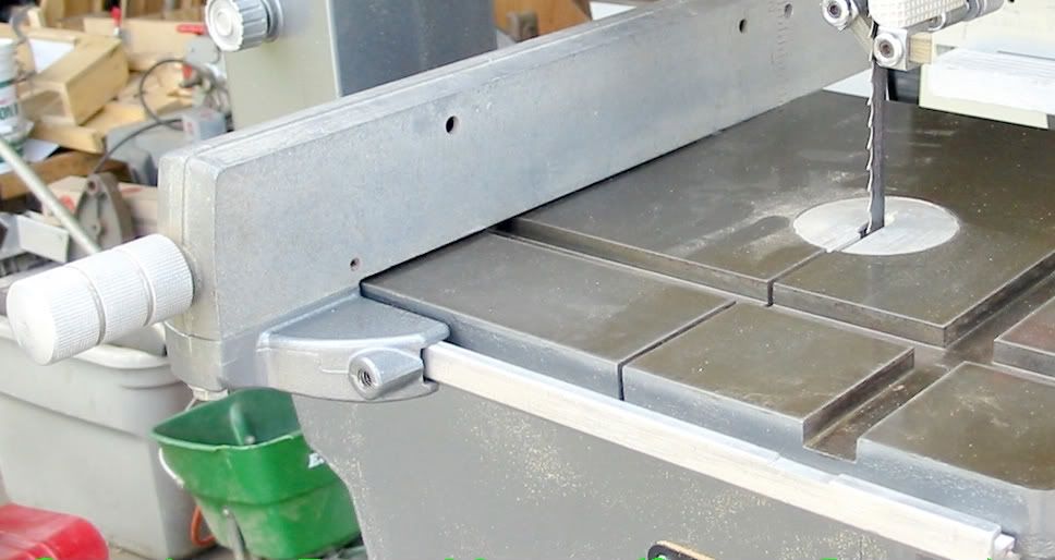

This is one of my bandsaws with a cast iron table.....JPG40504 wrote:If the bandsaw has the cast iron table, only the miter gauge is intended to be used as a fence.

Due to a Shopsmith factory blunder, I received 2 bandsaw fence kits.. Talked to Shopsmith about it and they have yet to be able to identify their oversight on the double shippment.. Hence both fence kits were received under the same shipping document but only one was ordered and charged for. Guess the packers were feeling giving that day.. Anyway, I'll send you the fence kit for half the cost of a new one from Shopsmith plus actual shipping

Rob,
I have a left of 500 fence and table. Can you explain or show pics of how you attached the fence rail to the cast iron table. tks

To mount the fence, I took advantage of the holes already in the table. Lined up the right end of the fence bar close to the right side of the table and marked the bar for drilling. Mount the bar and then mark the bar for the miter slot. Remove any material in the bar that interferes with the miter bar travel over the fence bar. Once you adjust the fence for drift, it is much easier and quicker (IMO) to set than the miter gauge for resawing.
