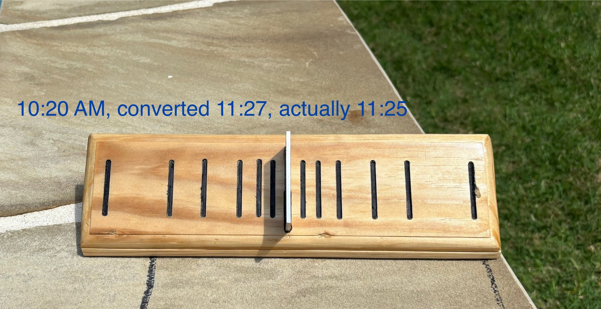

I have never routed anything until this year. I found that you can quickly make a mess with a router than can be difficult to cover up. Whether that be tear out or a burr, letting the base or guide off the supporting structure for a moment can mar your work.
Here is the sundial I made. You can see mistakes on the far R line (5 PM mark) and the Ogee bit used on the edge. I used a homemade jig for these parrallel lines.

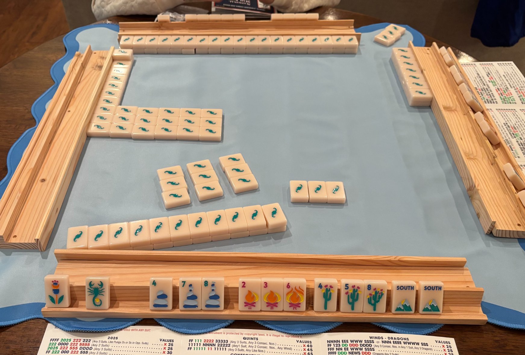

I had similar problems with routing a flat bottom on these game tile racks. The bottom of the U shape had divots and burrs from either the unevenness of the stock and/or letting the router off a support for a fraction of a second. I used the Bosch router guide for this project. I do not have a router table. I think an upcut or downcut bit may have helped make it smoother.

Tell me about hat linear sun dial.

Regarding linear sun dials (best used near the equator - also must be re-calibrated when used on other planets - don't even attempt in a binary star system
https://lyncean.education/projects/astr ... -sundials/
Excerpt:
"For latitudes near the Equator, a “polar” design is much better. In this design, you make the plate and the style parallel to each other, and you tilt both of them. This makes the design very long and thin and suitable for tracking the overhead path of the sun at the equator. (At the poles, the circular “clock-face” design is best. At the Equator, the linear “polar” design is best. In between, you get to choose.) Here's a paper polar sundial designed for 30° latitude:"
Excerpt:

This is indeed a polar sundial. I will not bore you with all the astronomical details, but the gist is that the face is at 34.5 degrees (my latitude) and the lines are spaced in relation to the height of the gnomon (the aluminum blade in the center). There are many types of sundials that all have advantages and disadvanatages.
I used a cheap straight bit to make the lines and I now know (in hindsight) that an upcut bit would have been a better choice. I understand cutting across the grain is less than ideal as well. I did not know about the tape strategy but might try that in the future.
My sundial is very accurate for what it is, as you can see from the picture with time stamps that I posted. Overall, I was very pleased with it for a first effort. I thought of other ideas on how to make it even better, with a dial for times near noon and a second dial for morning/afternoon times on the same device. Geometry prohibits making it accurate for all times with one device and it can never measure earlier than 5:30 AM or later than 5:30 PM.
