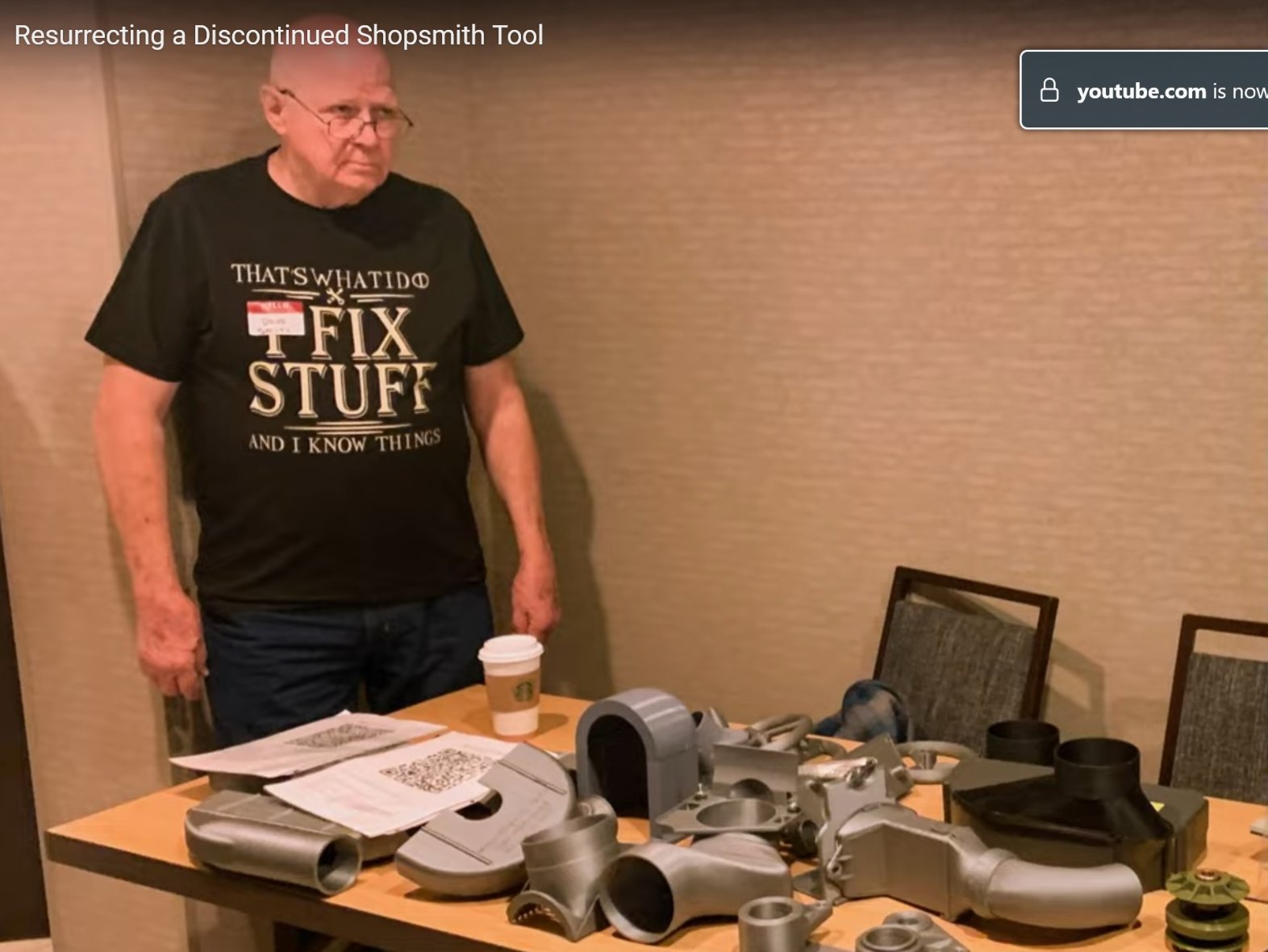

As for the 3 way port, I have been thinking since the start of this that it's a terrible design and likely a source of a LOT of turbulence that impedes airflow. I have a 3D printer and would be interested in having the contact info of the person you mentioned, if he's willing to share some models. I'm not ready (yet) to get into running 4" hoses around my shop, but a straight shot through the hole where the 3 way port mounts would probably be much better than the 3 way port design. Even a small baffle to direct the airflow through the 3 way port would likely help quite a lot.

Yes, I do think the 3-port manifold ends up being too restrictive because a) it doesn't provide a smooth, gradual transition for airflow and b) the interior design of it makes the airflow too turbulent. There used to be a Shopsmith gradual bend 90° elbow that could replace the 3-port manifold. This would allow one to make a permanent 4" PVC dust collection system. Unfortunately the original DC-3300 is really too under-powered for this. Probably why they stopped offering it long ago...that and demand was probably low for it. You can see at the link below what that Shopsmith 90° elbow used to look like. It might be a better starting point for your 3D printing endeavors. In fact, all that you need is a flange that would mate with the area where the 3-port manifold mounts, then transition it to a suitable dust port coupling for attaching your hose. IF you want to have 2 hoses connected then design for a "Y" instead of a "T" connection to give best airflow to each. I think most of us, if we knew/saw the difference with a 3-port manifold replacement would jump at it. Imagine a good "Y" fitting there instead of that restrictive 3-port manifold. So, I don't have any contact info for the Shopsmith 3D printer guy who sells what he creates. I don't believe he is on this forum, but I believe he can be reached through the Shopsmith group on Facebook. His name is Doug Smith. Scott talked about what different products Doug Smith offers for Shopsmith and he had them on display at the Shopsmith 75 anniversary celebration. It is a long interview but somewhere in this interview you can see some of the 3D printed products from Doug if you want to watch it. Good luck and please report what you try and how it works for you!

Shopsmith 75 Year Anniversary Celebration Interview: 3D printing from Doug Smith
https://www.youtube.com/watch?v=22g_lHX ... rowthRings

I found another video from Scott where he talks about parts that Doug Smith has 3D printed for Shopsmith. It starts around about the 1:30 mark so easier to find than the previous video I posted. Video is below, but there is a snapshot below it showing different 3D parts Doug has printed.

I posted this in the video description of the last video shared by RF Guy: Contact Doug via email at: douglas.techno.smith(AT)gmail(DOT)com and let him know that I sent you and that you are interested in a download of his catalog of 3D products, as well as the STL file for the chisel guide.
