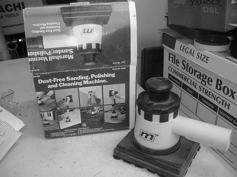

I would say you don't have a vacuum powered sander right? I got one just about 26 years ago and the only thing wrong with it is that it takes it toll on dust filters. This new system may change all of that, and I'd like to test it out.
You are correct in saying a sponge or wet cloth does work well on mud I don't like that method as well for spackling which is another thing on my todo list along with some painting and trying out that new green painters tape... never a lack of things to do around home.

The damp sponge is also easier on the paper surface of the drywall.reible wrote:I would say you don't have a vacuum powered sander right? I got one just about 26 years ago and the only thing wrong with it is that it takes it toll on dust filters. This new system may change all of that, and I'd like to test it out.
As far as spackling, why not use mud for that also?
When I was finishing my basement I got one of these:
http://www.amazon.com/MT800-Sand-Kleen- ... B00005A1K8
Works really well, you get the speed of screen sanding (wet sponge works but takes to long for a large area), and good dust control. Just make sure to set the air bleed right or the sand head wants to stick to the wall and makes it hard to sand.
