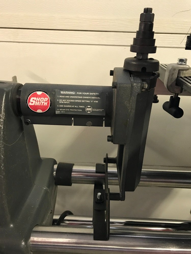

If you want to do under table Routing or Shaping there is another option, but it now has to be found on the used market. The Speed Increaser runs at up to 10,000 RPMs almost doubling the Conventional Headstock speed. Prior to getting the Power Pro upgrade I used it for under table Routing but as I said before it is still slow for Routing and Shaping. Below is my Speed Increaser on my Mark V 520.
_
Speed Increaser on my 520.jpg (101.73 KiB) Viewed 12617 times
