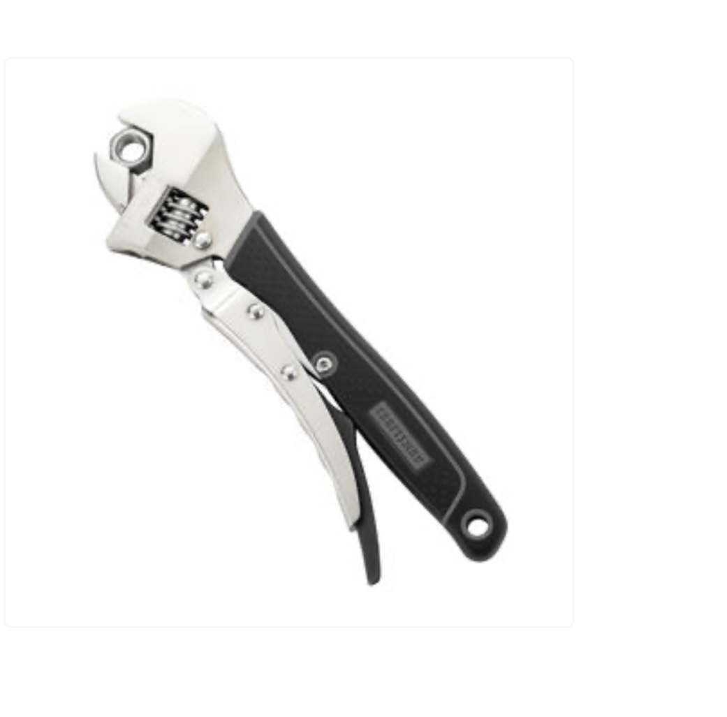

I don't disagree with you if you can get a quality adjustable wrench. The challenge for me has been as follows. I have all the basic mechanic type tools from when I wrenched on my vehicles when I was younger. Problem is none of my open end wrenches are large enough to fit the arbor nut. Of course I have multiple sizes of pipe wrenches for plumbing, but those would destroy the arbor nut. I always planned to one day buy a more expensive and more complete set of sockets (impact and standard) and open end wrenches for my shop, but still today I haven't made that investment unfortunately. I wrench on cars a lot less today than I did when I was young. I have a couple of small Crescent brand (adjustable end wrenches), but I use them sparingly. There is just too much play and that tends to round over the nut you are loosening with time. The newer China built ones are even worse than the older ones. Perhaps if I could get my hands on a 1950's vintage or earlier Crescent wrench then I might be happy with it. With what is commonly available today, I would suggest either getting the exact size box end wrench with long handle and/or purchasing the Shopsmith arbor wrench. An adjustable end wrench (Crescent I believe invented these) can certainly be used, but is less desirable IMHO. Am I being too picky? Certainly there is nothing special about the Shopsmith arbor wrench except that it has both sizes needed in one wrench, but you need two of them to be useful. Am I the only one that has a preference for using exact size wrenches versus an adjustable one? I believe today all of Crescent's wrenches are made in China and machinist reviews of them haven't been favorable. In general I love Crescent tools and their new parent company Cooper Tools, but I don't like it when quality tools get moved to offshore manufacturing lines that are of less quality. :(

Post by cooch366 »
Maybe this Craftsman wrench will work. I have a couple of them and the “vise” grip function takes the slop out of using it.
