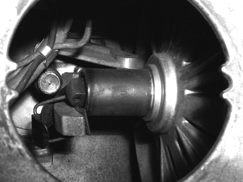

If you look inside your access hole and see something that looks like this, you know you need to take your wallet out.
[ATTACH]4905[/ATTACH]
Removing the speed dial works quite nicely.
- trashed speed control.jpg (70.99 KiB) Viewed 6920 times
