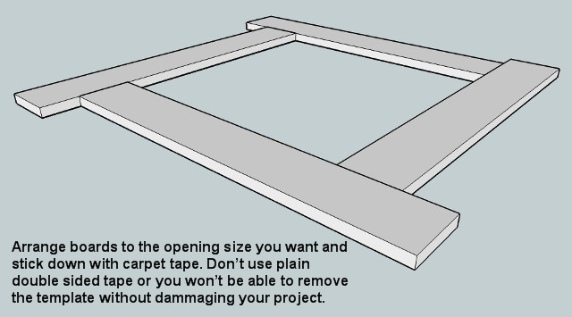

You do not need to pocket screw them together. Simply use some carpet tape on the bottom of the boards to hold them in place. Looking at the attached picture you can see that the boards don't have to be the same length, but they do have to be the same thickness. Using this method you can make the opening any size you want using the same boards. For instance; if you have a square piece to inset into a table, or whatever, just place the object where you want it to go, arrange the template boards around the object as shown and you have your routing template. You could also simply mark the cut-out where you want it and stick the template boards around the marked, soon to be, opening.

[quote="curiousgeorge"]You do not need to pocket screw them together. Simply use some carpet tape on the bottom of the boards to hold them in place. Looking at the attached picture you can see that the boards don't have to be the same length, but they do have to be the same thickness. Using this method you can make the opening any size you want using the same boards. For instance]
Now you tell me! Just Kidding. Thanks for the advice. I got the jig made and started routing last night. The next problem I ran into is my router bit isnt long enough. That'll teach me to make the jig out of 3/4 inch wood!!
