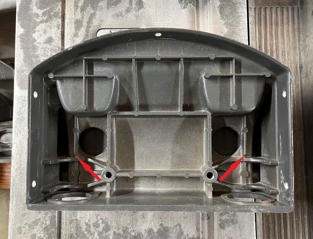

When attaching the Bench Tubes to the Base/Arm and Headrest ends make sure they are seated properly. On the Base/Arm end the Bench Tubes should be against the stops indicated by the arrows in the picture below. Having the tubes against the stops has them across both casting parts and keeps them aligned and properly clamped in place.
_
Base and Arm stops.jpg (225.64 KiB) Viewed 74014 times

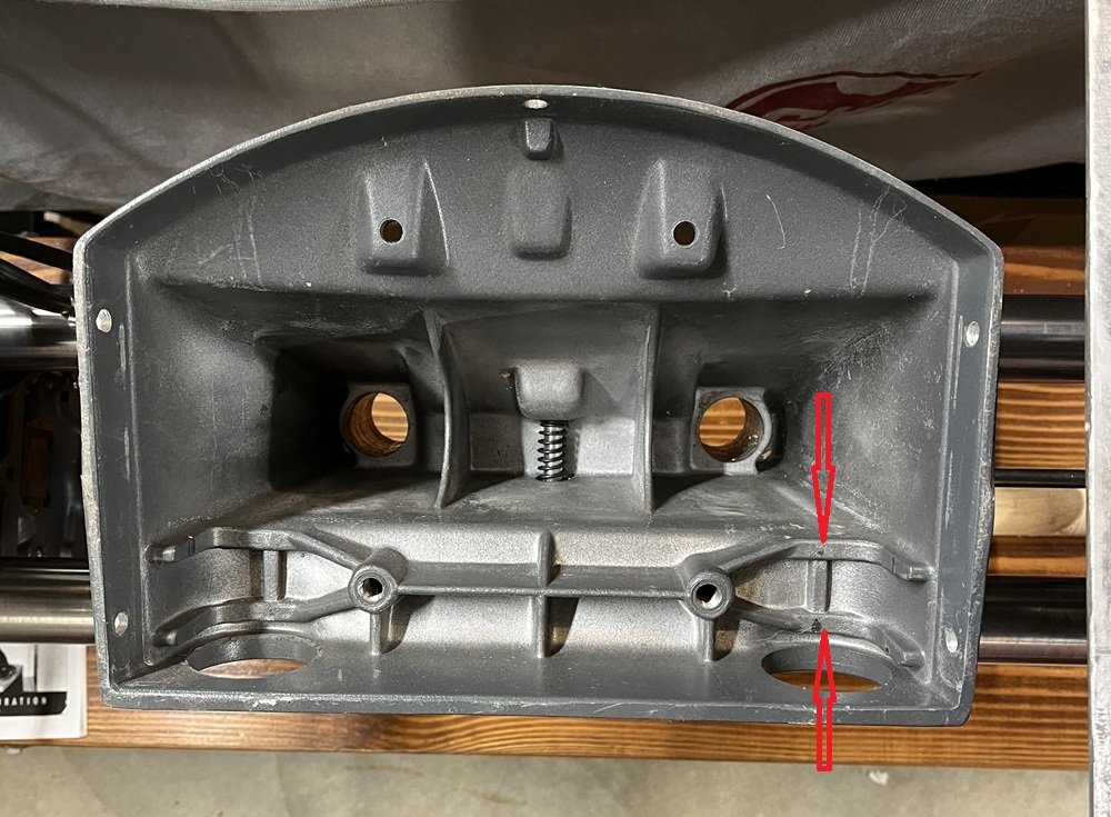

On the Headrest end the Bench Tubes need to be across both casting parts that the tubes rest on as indicated by the arrows.
_
Headrest underside - arrows.jpg (155.54 KiB) Viewed 74014 times
