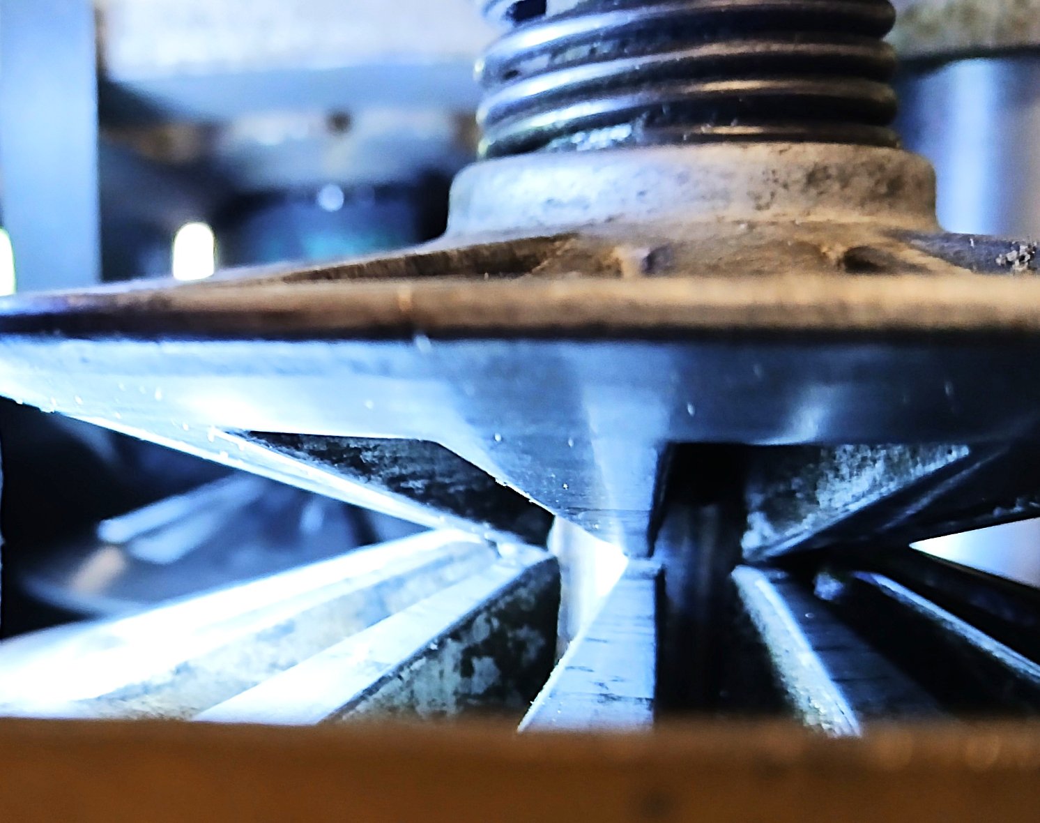

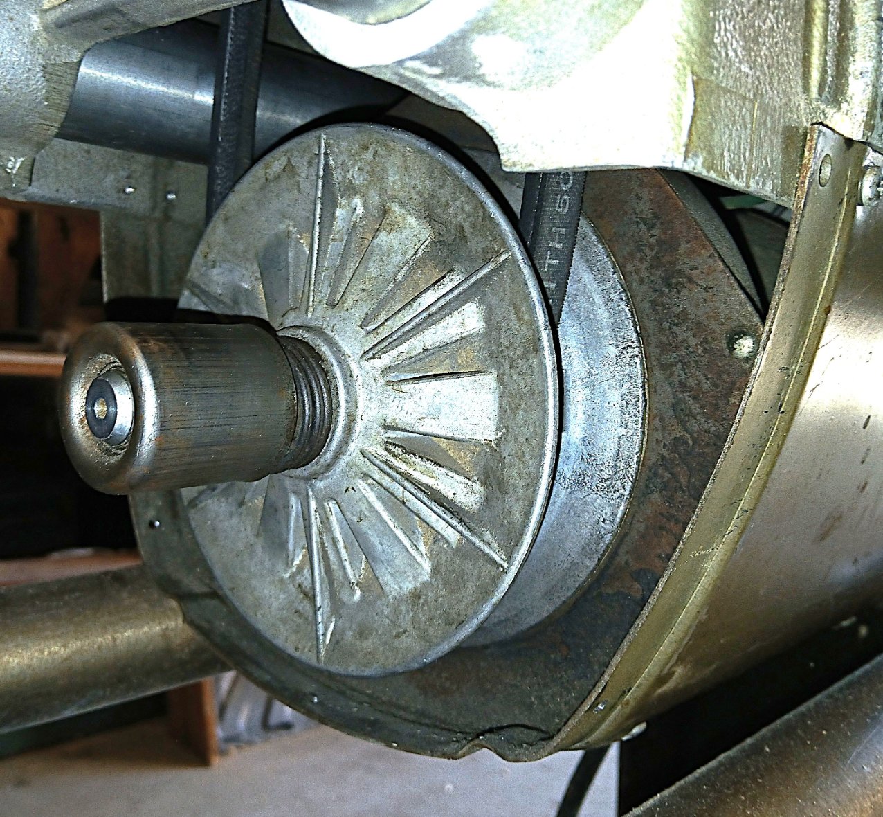

Hi,
About two weeks ago I was using my 1955 greenie and, after turning it off briefly, when I switched it back on the motor ran but the spindles did not turn.
I opened it up and found that the drive belt was slack and the sheave was fully open (i.e., the flange halves were as far apart as they could get). Note that this is against the spring's compression. I managed to get the sheave halves free though it took some doing because they were jammed together some how. It worked for a while, but today the same thing happened. Since it appears to be a recurring problem I have come here seeking advice instead of doing the same thing again.
This is what it looks like. Anybody seen this happen before? Thanks,

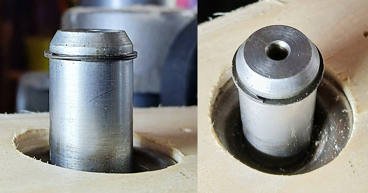

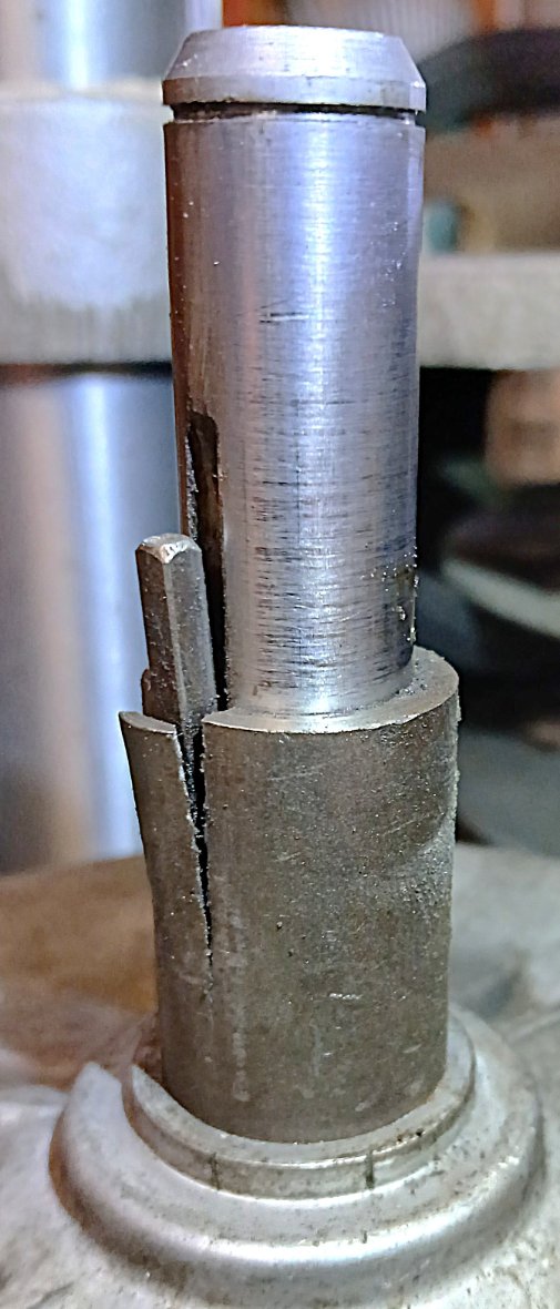

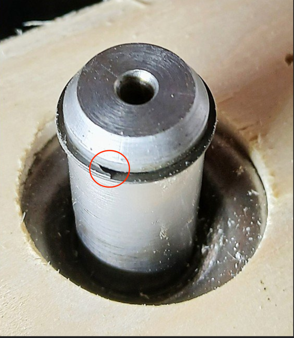

Since my original post I done a little more.
First I more closely examined the sheave half positions as shown in the first picture. Clearly the key is not doing its job. I managed to get them realigned into the norman position.
I made a spring compressor and examined the end of the shaft. Though the 1955 manual indicates a nut on the end, there is a retaining ring.
It is in the second picture below. I do not know how to get a ring like this off without risk of destroying it. Is there a tool for this style.
If I can replace the ring and cup with the newer ring and washer, I'd be OK with that and wouldn't worry about the old washer. Does anyone know if the current ring will fit the 1955?
Also, since it is apparent that I need a new key, I looked for it on the Shopsmith.com parts page and it comes up "404 not found." Is this part available?

Re: Floating Sheave Is Stuck "Open"
To remove the ring, put a small screwdriver under the recess circled and gently pry it out & up. You can then carefully unwind the ring by prying up on it as you walk around the shaft. Installation is essentially the reverse.
Here is a link for the key below.
Link: https://www.shopsmith.com/product-page/ ... headstocks
If you use a seal pick and 2 thin blade screwdrivers you should be able to remove the snap ring without damaging it.
I use the seal pick to pry it away from the shaft using the little tang on the end of the snap ring.
Then put the screwdriver blade in the gap and work it out of the groove.
Hope this helps.

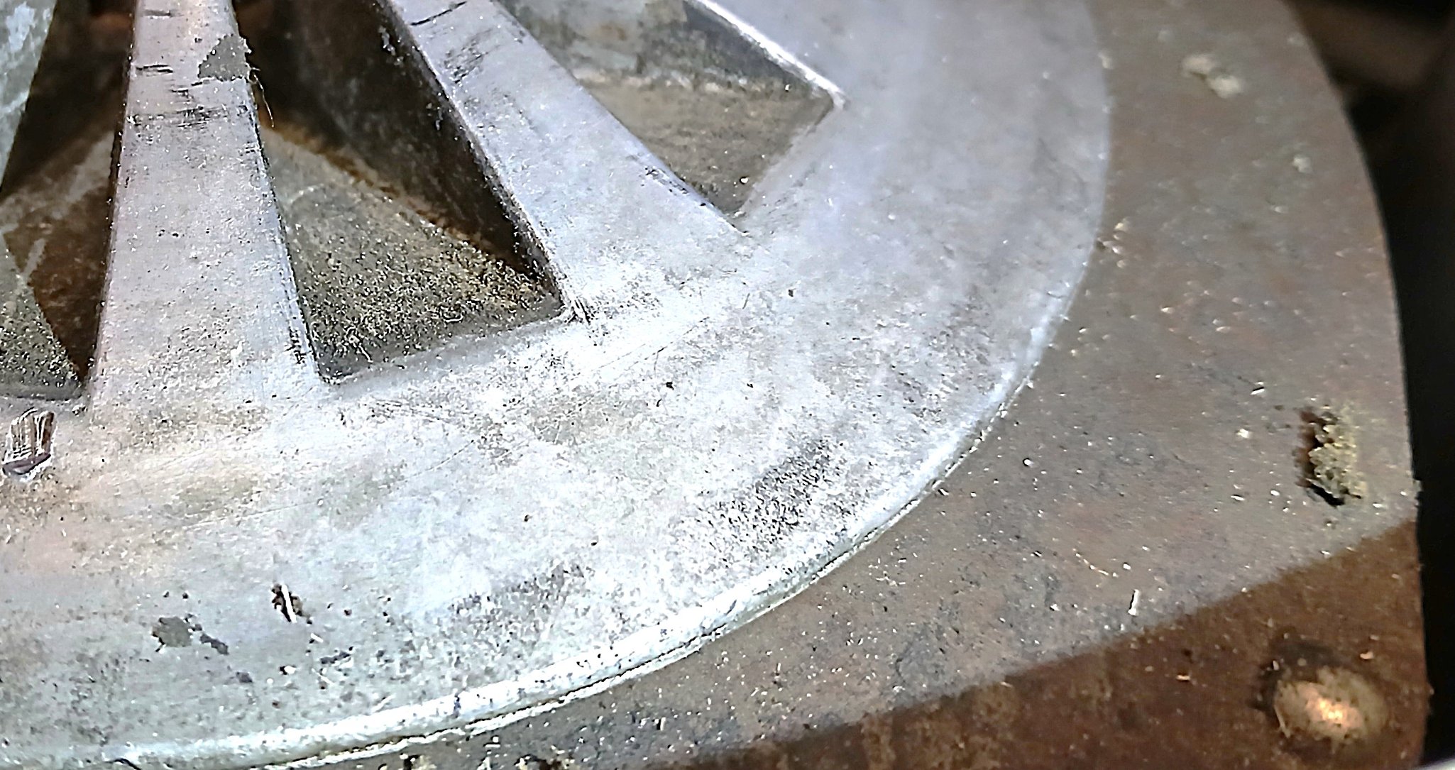

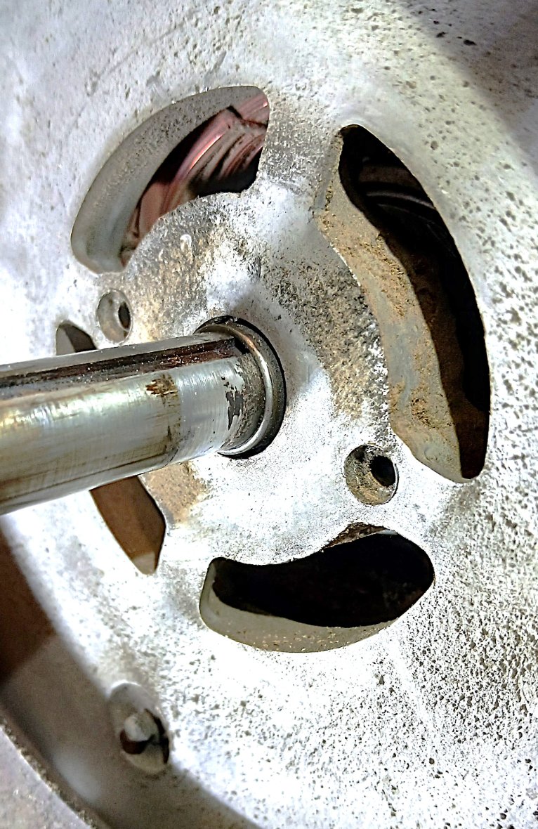

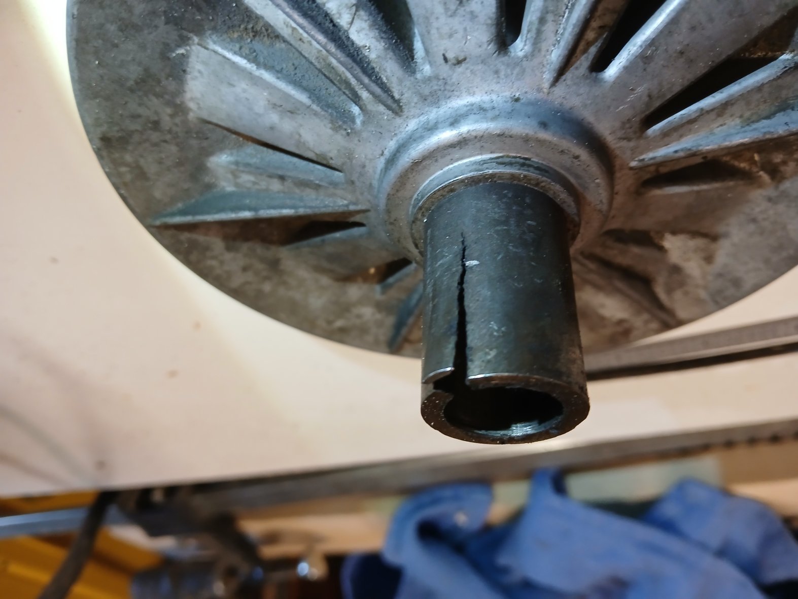

OK,
Using the help I got here I got the ring and spring off. The first and second pictures show what I found -- the key broken out the side of the floating sheave. So, that's a problem. I also found that the fan sheave was smashed down against the motor plate and would not turn. This was not the case yesterday, so I can only think that I drove it down while removing the spring. (Pictured below.) When I removed the fan sheave, I found what I think is the sheave spacer jammed down into the motor plate with about 3/32" showing. pictured below. Is that what I'm looking at? As a minimum I need to replace the floating sheave and key, and I'd replace the fan sheave while I'm at it. But, is there a way to fix the apparent spacer problem? Do I have to replace the motor? Headstock?
You'll need to polish the shaft before you put the new sheave on. I would also put new bearings in the motor if I was that far into it.
If the Motor is the original 3/4 HP Motor and you are considering replacing it, I would recommend looking into that first. A replacement may have some or all of the Motor Pulley parts included. A new Motor from Shopsmith, although currently listed as unavailable, does not come with any of the Motor Pulley parts. A used one may have some or all of the parts needed. Used Motors are commonly found for sale online as owners upgrade to the Power Pro DVR Motor. The Sheaves, Key and Spacer are all currently available from Shopsmith. Since these are not parts I have had to replace on any of the Mark 5/V's I have owned/restored I cannot confirm if the current parts are all compatible with the early Greenie Mark 5's with the 3/4 HP Motor but I believe they are. Hopefully someone else can confirm.
- Posts: 4555
The replacement parts (with Part Numbers) mentioned are the Fan Sheave P/N 504207, a Set Screw P/N 513016 (for the Fan Sheave), Floating Sheave P/N 504208, Sheave Spacer P/N 504205 and the Long Key P/N 504209 which in total cost $111.75 plus shipping, new from Shopsmith. The original Fan Sheave Set Screw may be able to be used again. Hopefully the Spring and Spring Retaining parts are still usable.
You can use the above information in considering if buying an upgraded replacement 1-1/8 HP Motor would be a good idea. For part of that consideration, I would recommend running the Motor you have with the Pulley parts off to see if it still runs okay. Start with turning the Motor Shaft by hand to see if it turns freely and smoothly then with power.
Russ and gleno,
Thanks for the input.
Following the suggestion I just turned on the motor and it runs fine.
I think that changing the motor bearings and polishing the shaft are good ideas, but beyond my skills and equipment.
At this point I'm weighing the possibilities of replacing the headstock. Despite the sentimental aspect of my father's Shopsmith, I've experienced a couple of failures in recent years that shut me down for a week or two. I doubt it is going to get better.
Looks like I can get a used later model with 30+ years less wear and sexy features like an access port, 1 1/8 hp motor and dual bearing quill for a few hundred dollars.
If I go to Shopsmith for a new one, seems I might as well go for a Power Pro for $3k vs conventional for $2k.
Meanwhile, I took a closer look at my 1955 manual and I see that it does not show a spacer. I guess it was always held in place with just the set screw. Is that possible? Did I drive the fan sheave down onto the motor plate when I compressed the spring?
