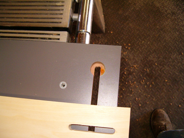

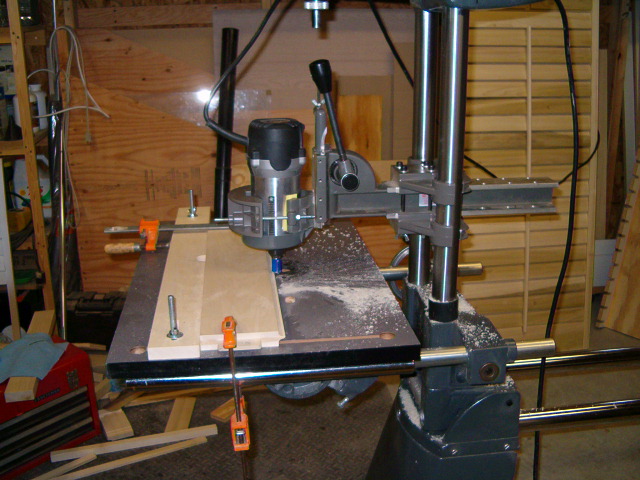

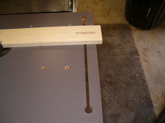

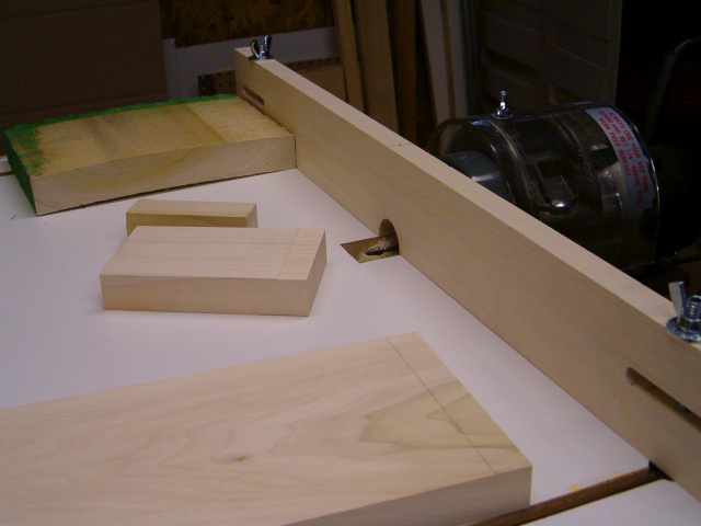

- cutting/routing slots through the new OPR table is not necessary for many operations. However the shopsmith aluminum fences leave much to be desired. I routed slots to improve the machine's capabilities.nuhobby wrote:Hi,

Before routing the slots, I used a longer piece of UHMW Plastic for a fence. I drilled one side of the plastic, screwed it to the table and clamped the other side. Pivoted the fence to adjust it.
After routing the slots, I now have a 3/4" X 4" straight piece of poplar that I use for a fence. NOTHING fancy here! It (the fence) can be installed on it's face or on it's edge. It is VERY easily adjustable.
[ATTACH]5091[/ATTACH]
Here a a couple of photos. As you look at them PLEASE realize the two holes on the inner side of the fence were made in error. If you make these slots - DO NOT MAKE THE HOLES ON THE INNER SIDE OF THE TABLE. This shows the oak filler I have put into the bottom of the counter bore.
[ATTACH]5092[/ATTACH]
I have since inserted oak into the bottom of the slots and cut the rabbets into the oak. This is a lot more firm than the inside of the fiber table. It also covered the hole from the bottom.
With the wood fence, I can now use the fence on either side of the router. The next photos shows a set-up for routing a dado into the center of a shutter rail.
[ATTACH]5093[/ATTACH]
The last photo shows using the same fence with a sliding table to use in horizontal boring.
[ATTACH]5094[/ATTACH]
