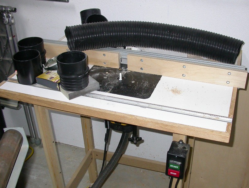

Use melamine coated MDF, mine is 3/4" thick with a band of oak to both finish the edge and give additional strength against warping.
I used two Shopsmith miter tracks so I can use my Shopsmith miter guage and other accessories.
[ATTACH]123[/ATTACH]

I have a DeWalt 3 HP (825 I think) and it is very heavy. I have had this table for over 10 years and no warping. The legs are screwed into the panel from below and as you can see in the picture they are just outside the insert (giving some support). In fact I had to use shorter screws to install the legs otherwise the screws would protrude through the miter track.
