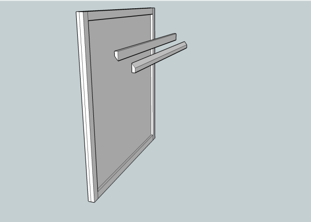

I would suggest a hybrid method, using part of Jim's approach and part of what I use.
I understand Jim,'s adversity for connection anything to his concrete basement walls. Hanging a vertical support from the rafters (floor joists) is an excellent idea. Putting a frame all the way around the peg board is also an excellent idea. The only change I would make is that the top (horizontal) member of the peg board frame would be beveled at a 45 degree angle. Then a horizontal member with a reverse bevel would be attached to the vertical runners. The peg board can then be moved around at will.
[ATTACH]5274[/ATTACH]
- Peg Board Panels.png (26.89 KiB) Viewed 17522 times

Gotta love those French cleats! It's an easy way to hang cabinets as well!!dusty wrote:I would suggest a hybrid method, using part of Jim's approach and part of what I use.
