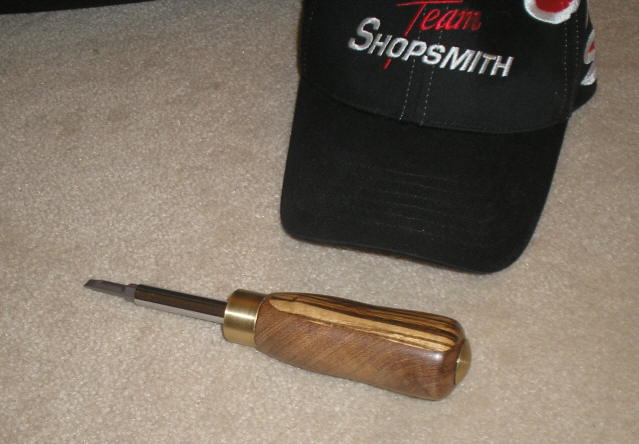

Woods Together are always Nice
Hi,
Especially for small projects, combining different woods can turn out great.
Here is a screwdriver done with 2 woods, as shown:
- Mesquite and Zebrawood Screwdriver.jpg (43.16 KiB) Viewed 7604 times
Chris
Hi Bob,rdewinter wrote:Chris
Very nice looking screwdriver. Did you just face glue the different woods together before turning? How long did you wait for the glue to be completely dry before turning?
San Diego
Yes, those were some castaway slabs that I sanded fresh/flat and face-glued together. Sometimes I use wood-glue, and if in doubt I'll use epoxy. I routinely wait 24 hours for my cure. For this screwdriver example, the "wood sandwich" layers were well-aligned with the turning axis. However other times I've done a deliberate slant of my drilled turning axis, so that each sandwich-layer has an interesting elliptical intercept with the final turned shape.
All in all, that extra 24 hours waiting for glue up front is well worth it for the interesting outcomes later.
Other points from reading articles are: For large turnings, normal wood grain can exhibit quite nicely. For very small piece turnings, it's worth the effort to locate a more figured portion of the wood. I like a pretty hard wood not only for the beauty, but also for the fact that it's not as easy to mess-up if I have a sudden mistake or "catch" when turning.
Enjoy your projects,
Chris
