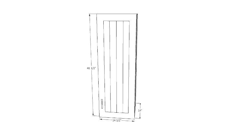

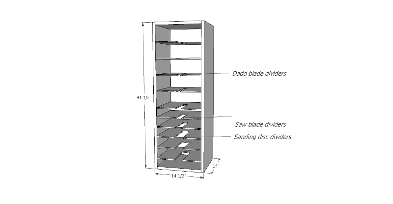

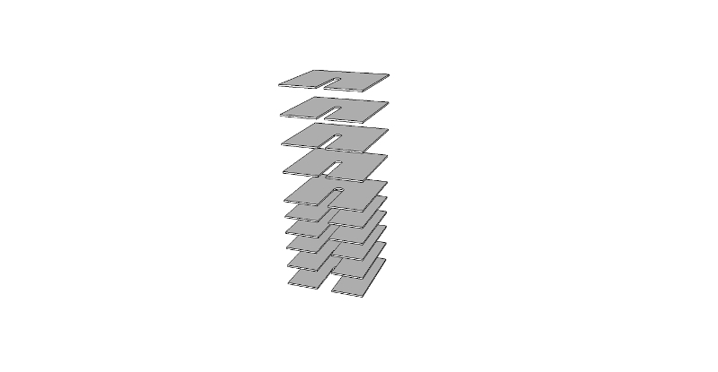

Using the newly acquired knowledge from Sketch-up 101 I drew this storage cabinet for my sanding disc, saw blades, and dado blades. If you are not taking advantage of Toms class you are really missing out.
[ATTACH]5415[/ATTACH]
[ATTACH]5414[/ATTACH]
[ATTACH]5413[/ATTACH]
This will hold all my Shopsmith disc and blades on arbors. I still have to organize the 30 plus blades for my other saws.
I did it all by myself!

Looks good, Mark! I really hope to have time to learn Sketch-up some day, and Tom's doing all of us a great service with his tutorials!
Just a minor possible design modification- If you make the cabinet just a few inches wider, and offset every other blade, you could reduce the height substantially by alternating arbor directions. For example, put the "arbor-up" disks on the left and the "arbor-down" disks on the right. And the "arbor-up" set can use plain (unslotted) dividers.
Gary
Gary
