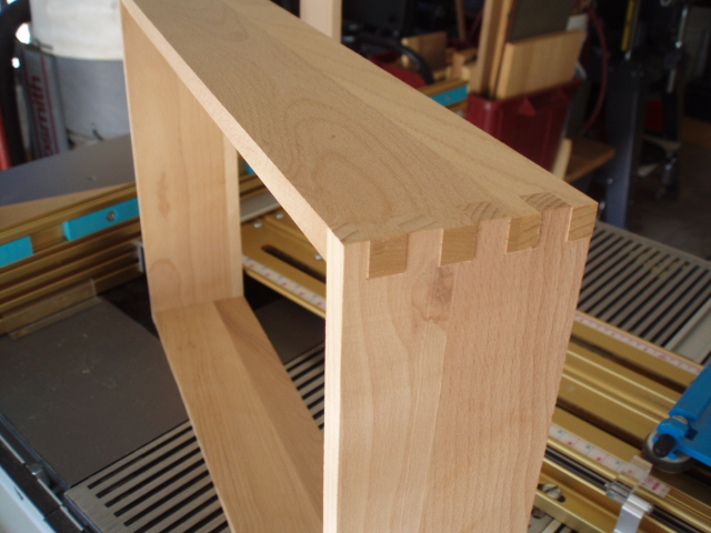

[ATTACH]5438[/ATTACH]
Have you considered using a router?
- P6200001.JPG (143.41 KiB) Viewed 6672 times
WOW! GREAT BOX JOINTS. Did you do them with a router?

These cuts were made with a router and the measurements were made tape measure with 1/32" markings.
Measuring and cutting the guide pin to match the measurements of the dado blade or router bit is, IMHO, the key to success.
If you declare the router bit to be 1/2" and it is actually .495", the joints do not fit perfectly. The error, .005" is pretty darn good until it begins to accumulate with multiple cuts. The accumulated error can result in a set of joints that won't go together at all.
Spend some time determining the width of your cut and then matching it with a perfectly fitting pin.
Incidentally, this is what makes box joints with a saw blade so difficult. Each and every edge defining cut with the saw blade needs to be exact.
