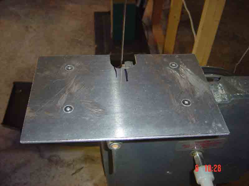

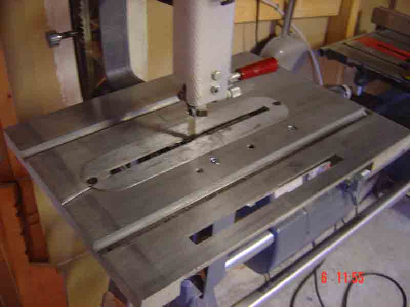

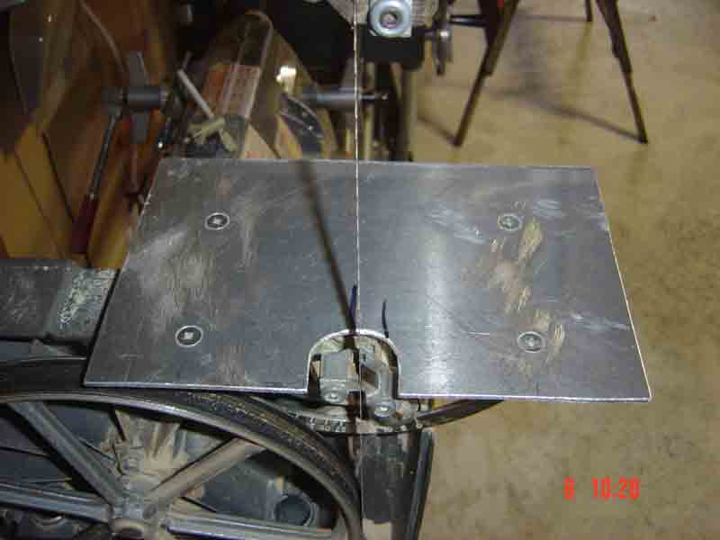

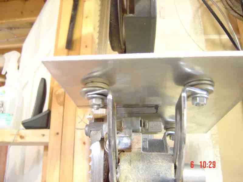

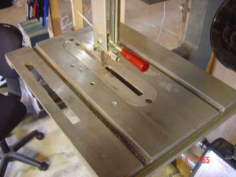

Here are some pics of my table swap. The first two show a sub table I made up in order to attach the new aluminum table. The last two show the finished swap. Will now be able to use a common rip fence. Tks for all the replies especially the details from JPG40504, excellent!!
Cheers
Jim
