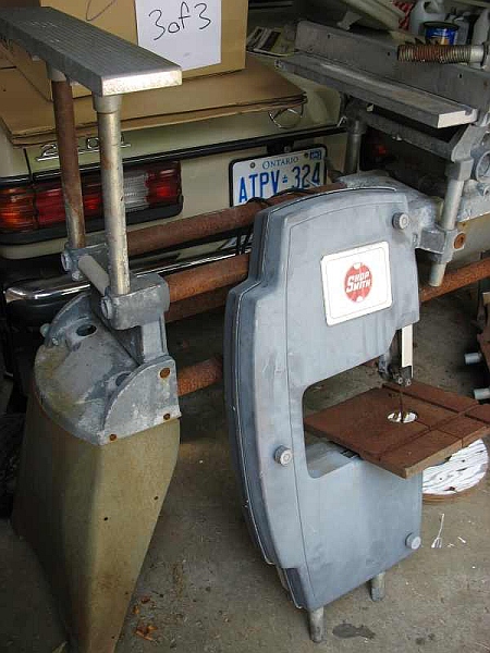

I went out and bought the neglected Shopsmith today. The guy sold it to me for $75, since I pointed out it's missing a few pieces. At that price, I figured I couldn't go wrong (it has the bandsaw and jointer attachments).
Well, I will be spending some time carefully taking apart and inspecting this specimen, and hopefully getting it back into some kind of usable shape. I sort of like cleaning and restoring things, so this could turn out to be an interesting project.
One thing I am happy about: this poor neglected tool won't have to spend another night out in the rain! ;)

I am curious as to what the item with the crank handle is on top of the table in the 'original' pix.

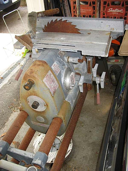

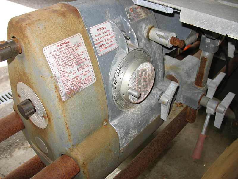

Glad you DO enjoy 'resurrecting' stuff. If so this WILL be a picnic. BTW the later pix indicate a much newer version than at first we thought. It has a "B" headstock with lock out holes on the switch 'wings'. This means a 1 1/8HP motor with a simple centrifugal start switch.

I just took off the front cover of the headstock. Bit of sawdust in there but not too bad. Both shafts turn freely. Belts looks good. The engine is indeed an 1 1/8hp for which I am thankful. I haven't tried to power it up until I do some more checks, as guided by the shopsmith videos and the posts to which you've pointed me to.
Used some scotch scouring pads and a bit of 600 grit paper to a section of the upper tubes, and they are coming out reasonably smooth and clean. So hopefu lly the rust wasn't too deeply set in.
